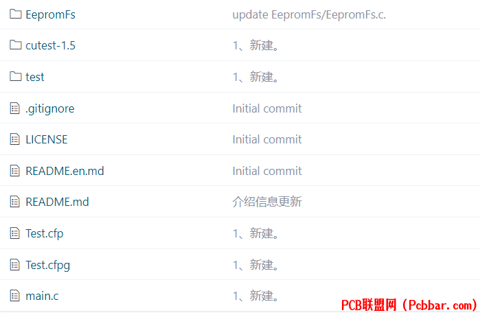

开源地址:https://gitee.com/wtau_zaozao/eepromfs
