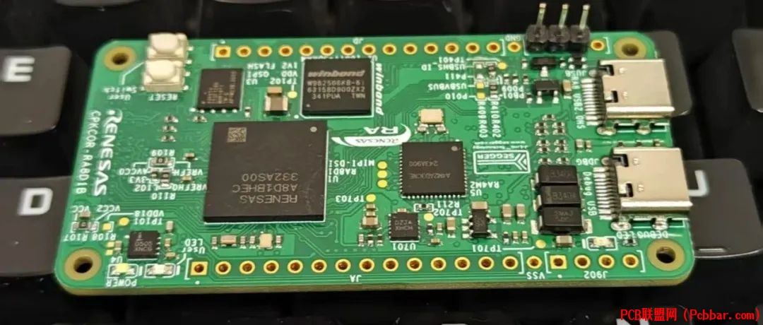

硬件
主控芯片: 瑞萨RA8D1单片机电机驱动: L298N电机驱动模块传感器:超声波传感器 (HC-SR04) 用于避障红外传感器 (TCRT5000) 用于巡线蓝牙模块 (HC-05) 用于遥控电源: 7.4V锂电池其他: 车轮、底盘、舵机等[/ol]软件

  • #include "r_smc_entry.h"#include "r_gpio_rx_if.h"#include "r_pwm_rx_if.h"
    #define MOTOR_LEFT_FORWARD    (BSP_IO_PORT_01_PIN_00)  // 左电机前进#define MOTOR_LEFT_BACKWARD   (BSP_IO_PORT_01_PIN_01)  // 左电机后退#define MOTOR_RIGHT_FORWARD   (BSP_IO_PORT_01_PIN_02)  // 右电机前进#define MOTOR_RIGHT_BACKWARD  (BSP_IO_PORT_01_PIN_03)  // 右电机后退#define PWM_CHANNEL_LEFT      (0)  // 左电机PWM通道#define PWM_CHANNEL_RIGHT     (1)  // 右电机PWM通道
    // 初始化电机驱动void motor_init(void){    R_GPIO_PinCfg(MOTOR_LEFT_FORWARD, GPIO_CFG_OUTPUT | GPIO_CFG_PORT_DIRECTION_OUTPUT);    R_GPIO_PinCfg(MOTOR_LEFT_BACKWARD, GPIO_CFG_OUTPUT | GPIO_CFG_PORT_DIRECTION_OUTPUT);    R_GPIO_PinCfg(MOTOR_RIGHT_FORWARD, GPIO_CFG_OUTPUT | GPIO_CFG_PORT_DIRECTION_OUTPUT);    R_GPIO_PinCfg(MOTOR_RIGHT_BACKWARD, GPIO_CFG_OUTPUT | GPIO_CFG_PORT_DIRECTION_OUTPUT);
        R_PWM_Open(PWM_CHANNEL_LEFT, 1000);  // 初始化左电机PWM,频率1kHz    R_PWM_Open(PWM_CHANNEL_RIGHT, 1000); // 初始化右电机PWM,频率1kHz}
    // 设置电机速度void motor_set_speed(uint8_t channel, uint16_t speed){    R_PWM_Write(channel, speed);  // 设置PWM占空比}
    // 控制小车运动void car_move_forward(void){    R_GPIO_PinWrite(MOTOR_LEFT_FORWARD, GPIO_LEVEL_HIGH);    R_GPIO_PinWrite(MOTOR_LEFT_BACKWARD, GPIO_LEVEL_LOW);    R_GPIO_PinWrite(MOTOR_RIGHT_FORWARD, GPIO_LEVEL_HIGH);    R_GPIO_PinWrite(MOTOR_RIGHT_BACKWARD, GPIO_LEVEL_LOW);}
    void car_move_backward(void){    R_GPIO_PinWrite(MOTOR_LEFT_FORWARD, GPIO_LEVEL_LOW);    R_GPIO_PinWrite(MOTOR_LEFT_BACKWARD, GPIO_LEVEL_HIGH);    R_GPIO_PinWrite(MOTOR_RIGHT_FORWARD, GPIO_LEVEL_LOW);    R_GPIO_PinWrite(MOTOR_RIGHT_BACKWARD, GPIO_LEVEL_HIGH);}
    void car_turn_left(void){    R_GPIO_PinWrite(MOTOR_LEFT_FORWARD, GPIO_LEVEL_LOW);    R_GPIO_PinWrite(MOTOR_LEFT_BACKWARD, GPIO_LEVEL_HIGH);    R_GPIO_PinWrite(MOTOR_RIGHT_FORWARD, GPIO_LEVEL_HIGH);    R_GPIO_PinWrite(MOTOR_RIGHT_BACKWARD, GPIO_LEVEL_LOW);}
    void car_turn_right(void){    R_GPIO_PinWrite(MOTOR_LEFT_FORWARD, GPIO_LEVEL_HIGH);    R_GPIO_PinWrite(MOTOR_LEFT_BACKWARD, GPIO_LEVEL_LOW);    R_GPIO_PinWrite(MOTOR_RIGHT_FORWARD, GPIO_LEVEL_LOW);    R_GPIO_PinWrite(MOTOR_RIGHT_BACKWARD, GPIO_LEVEL_HIGH);}
    void car_stop(void){    R_GPIO_PinWrite(MOTOR_LEFT_FORWARD, GPIO_LEVEL_LOW);    R_GPIO_PinWrite(MOTOR_LEFT_BACKWARD, GPIO_LEVEL_LOW);    R_GPIO_PinWrite(MOTOR_RIGHT_FORWARD, GPIO_LEVEL_LOW);    R_GPIO_PinWrite(MOTOR_RIGHT_BACKWARD, GPIO_LEVEL_LOW);}
    2、寻迹功能
  • #define IR_SENSOR_LEFT    (BSP_IO_PORT_02_PIN_00)  // 左侧红外传感器#define IR_SENSOR_RIGHT   (BSP_IO_PORT_02_PIN_01)  // 右侧红外传感器
    // 读取红外传感器状态uint8_t read_ir_sensor(void){    uint8_t left = R_GPIO_PinRead(IR_SENSOR_LEFT);    uint8_t right = R_GPIO_PinRead(IR_SENSOR_RIGHT);    return (left 1) | right;  // 返回传感器状态}
    // 自动寻迹void car_line_following(void){    uint8_t sensor_state = read_ir_sensor();    switch (sensor_state)    {        case 0b01:  // 左侧检测到黑线            car_turn_left();            break;        case 0b10:  // 右侧检测到黑线            car_turn_right();            break;        case 0b11:  // 两侧都检测到黑线            car_move_forward();            break;        default:    // 未检测到黑线            car_stop();            break;    }}
    3、超声波与距离
  • // 超声波初始化void ultrasonic_init(void){    // 配置Trig引脚为输出模式,Echo引脚为输入模式    R_IOPORT_PinCfg(&g_ioport_ctrl, TRIG_PIN, IOPORT_CFG_PORT_DIRECTION_OUTPUT);    R_IOPORT_PinCfg(&g_ioport_ctrl, ECHO_PIN, IOPORT_CFG_PORT_DIRECTION_INPUT);}
    // 获取距离uint32_t get_distance(void){    uint32_t duration = 0;
        // 发送10us的高电平脉冲    R_IOPORT_PinWrite(&g_ioport_ctrl, TRIG_PIN, IOPORT_LEVEL_HIGH);    R_BSP_SoftwareDelay(10, BSP_DELAY_UNITS_MICROSECONDS);    R_IOPORT_PinWrite(&g_ioport_ctrl, TRIG_PIN, IOPORT_LEVEL_LOW);
        // 等待Echo引脚变高    while (R_IOPORT_PinRead(&g_ioport_ctrl, ECHO_PIN) == IOPORT_LEVEL_LOW);
        // 开始计时    R_GPT_Start(&g_timer0_ctrl);
        // 等待Echo引脚变低    while (R_IOPORT_PinRead(&g_ioport_ctrl, ECHO_PIN) == IOPORT_LEVEL_HIGH);
        // 停止计时并获取时间    R_GPT_Stop(&g_timer0_ctrl);    duration = R_GPT_CounterGet(&g_timer0_ctrl);
        // 计算距离    return duration * 0.034 / 2;}
    5、通信功能
  • #define UART_CHANNEL    (2)  // 使用UART2
    volatile bool g_uart_rx_complete = false;char g_uart_rx_buffer[64] = {0};uint16_t g_uart_rx_index = 0;
    // UART回调函数void uart_callback(uart_callback_args_t *p_args){    if (p_args->event == UART_EVENT_RX_CHAR)    {        if (p_args->data != '\r' && p_args->data != '
    ')        {            g_uart_rx_buffer[g_uart_rx_index++] = p_args->data;        }        else if (p_args->data == '
    ')        {            g_uart_rx_buffer[g_uart_rx_index] = '\0';            g_uart_rx_complete = true;            g_uart_rx_index = 0;        }    }}
    // 初始化UARTvoid uart_init(void){    uart_instance_ctrl_t uart_ctrl;    const uart_cfg_t uart_cfg =    {        .channel             = UART_CHANNEL,        .data_bits           = UART_DATA_BITS_8,        .parity              = UART_PARITY_OFF,        .stop_bits           = UART_STOP_BITS_1,        .p_callback          = uart_callback,        .p_context           = NULL,        .p_extend            = NULL,        .baud_rate           = 9600,        .rx_buffer_size      = 64,        .tx_buffer_size      = 64,    };    R_UART_Open(&uart_ctrl, &uart_cfg);}
    // 发送数据到上位机void uart_send_data(char *data){    R_UART_Write(UART_CHANNEL, (uint8_t *)data, strlen(data));}
    6、主函数
  • void hal_entry(void){    // 初始化    motor_init();    ultrasonic_init();
        while (1)    {        // 获取距离        distance = get_distance();
            // 避障逻辑        if (distance 20)        {            stop();            turn_left();        }        else        {            move_forward();        }    }}以上只是智能小车设计的主要内容,提供一个指导方向,更多具体细节,需要大家自己在真正做项目时优化改进。------------ END -----------
