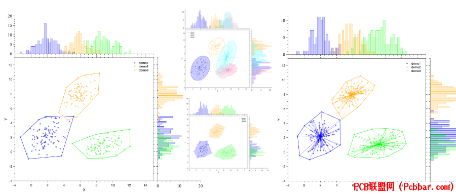

2 Y! I. K& H: ~+ P+ _7 D$ Y前面几篇推文详细的介绍了散点图和边际图的画法【MATLAB|回归曲线|置信区间|边际图|核密度填充图、MATLAB|聚类散点图|边际图|核密度填充图】,今天特意添加边际直方图的画法,喜欢此推文的小伙伴们记得点赞+关注+分享!【尊重作者劳动成果,转载请注明推文链接和公众号名】
6 a2 X5 a* p0 @效果效果图图, P. w7 Y5 t4 T5 s) K' [5 G
边际直方图效果图

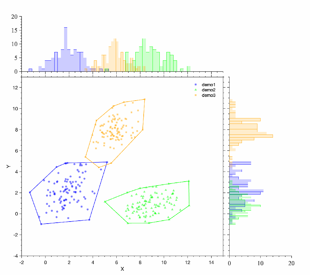

    [/ol]案例
  • clc;clear;close all;d1=repmat([2 2],100,1) + randn(100,2)*[1 .5; 0 1.32];d2=repmat([9 1],100,1) + randn(100,2)*[1.4 0.2; 0 0.98];d3=repmat([6 8],100,1) + randn(100,2)*[1 0.5; 0 1];
    8 I, i  H5 D: k/ B9 L' r% 使用scatter函数绘制散点图hold onsh1=scatter(d1(:,1), d1(:,2),'filled','CData',[0,0,1],'MarkerFaceAlpha',0.5,'MarkerEdgeColor','none','Marker','o');sh2=scatter(d2(:,1), d2(:,2),'filled','CData',[0,1,0],'MarkerFaceAlpha',0.5,'MarkerEdgeColor','none','Marker','^');sh3=scatter(d3(:,1), d3(:,2),'filled','CData',[1,0.6471,0],'MarkerFaceAlpha',0.5,'MarkerEdgeColor','none','Marker','s');
    ; F5 H$ G' y; w% 画出凸包k1 = convhull(d1(:,1), d1(:,2));k2 = convhull(d2(:,1), d2(:,2));k3 = convhull(d3(:,1), d3(:,2));line(d1(k1,1), d1(k1,2), 'Color', [0 0 1],'LineWidth',1.2)line(d2(k2,1), d2(k2,2), 'Color', [0,1,0],'LineWidth',1.2)line(d3(k3,1), d3(k3,2), 'Color', [1,0.6471,0],'LineWidth',1.2)legend('demo1','demo2','demo3','box','off','Location','best')% 设置标签和标题ax=gca;box onax.XLim=[-2,15];ax.YLim=[-4,13];ax.XLabel.String='X';ax.YLabel.String='Y';ax.Title.String='';8 R* d: O- ]/ X) _5 f* e
    ax.GridLineStyle = '-.'; % 设置网格线样式为虚线ax.GridColor = 'k'; % 设置网格线颜色为红色ax.XGrid = 'off'; % 关闭X网格线ax.YGrid = 'off';  % 打开Y网格线0 ]+ `% [$ j6 T$ o$ ?  ?
    ax.LineWidth = 1;            % 设置坐标线宽ax.XMinorTick = 'on';        % 打开x次要刻度线ax.YMinorTick = 'on';        % 打开y次要刻度线ax.TickDir = 'out';           % 设置刻度线方向向外ax.FontSize = 14;            % 设置坐标字体大小" I. O. n# c- q0 {; r! q5 C, i
    Phdl1=PlotDensHist(sh1);Phdl1.plotDensHist();Phdl2=PlotDensHist(sh2);Phdl2.plotDensHist();Phdl3=PlotDensHist(sh3);Phdl3.plotDensHist();) `! U6 z/ M/ t# Z: i! o" J( V; u3 X
