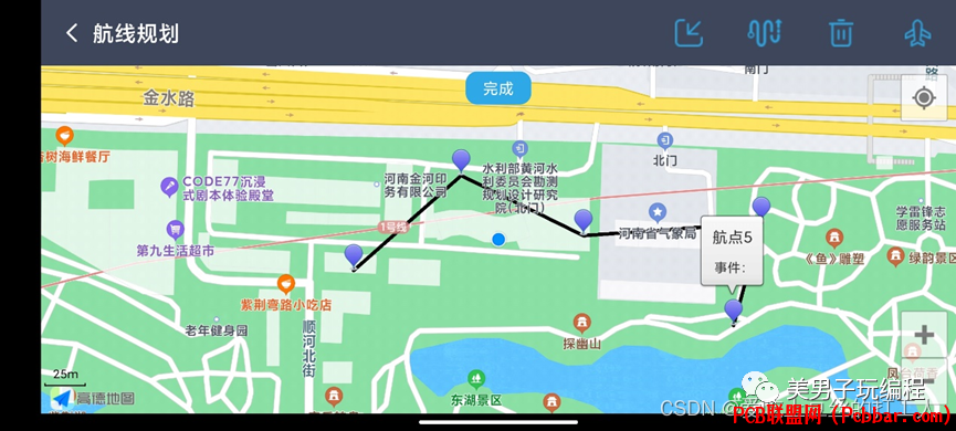

在地图中手动选择点位选择完成航线打点;若打点位置错了可进行点位删除。

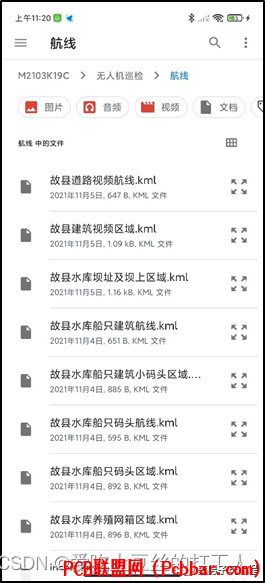

# h/ Q# v' b7 K% n4 L# x5 r; J" h点击[上传]按钮,进行航线上传。可以进入本地存储中选择航线文件进行上传,航线文件为 .kml结尾。2 S$ ^. H; c- I, R) F0 |0 m+ u

/ K1 w# O7 _  D+ l! c" O        public void onMapClick(LatLng point) {( @" N% p+ D) g* Y
            if (isAdd == true) {
5 S/ N3 ~# V' y0 j9 ~! l, i                markWaypoint(point);$ T% Q0 d+ e8 b, Z4 d  ?
                Waypoint mWaypoint = new Waypoint(point.latitude, point.longitude, altitude);, E5 l& _5 R! P4 Z
                //Add Waypoints to Waypoint arraylist;. N, }8 n5 i0 `& Z# c
                if (waypointMissionBuilder != null) {
4 K" L' [  W7 F( G7 }" v                    waypointList.add(mWaypoint);
9 y4 L4 G. ~( N- k                    waypointMissionBuilder.waypointList(waypointList).waypointCount(waypointList.size());8 }) d+ @' a* y
                } else {
; G. f  j7 j9 X- |# K- s7 _6 s                    waypointMissionBuilder = new WaypointMission.Builder();
" d" k! |3 y7 Z# h6 @                    waypointList.add(mWaypoint);' A# R( F! M  X  C' e2 l" s
                    waypointMissionBuilder.waypointList(waypointList).waypointCount(waypointList.size());2 \2 ]: ^, `# u  O0 _# Y+ f0 H
1 ?: h" U8 p8 ~3 f                mTextViewCount.setText("航点数:" + waypointMissionBuilder.getWaypointCount());* E, ^+ m/ x0 q2 l
                mTextViewDistance.setText("总距离:" + Math.round(waypointMissionBuilder.calculateTotalDistance()) + "m");
: E. e/ x" C0 G                mTextViewTime.setText("总时间:" + Math.round(waypointMissionBuilder.calculateTotalTime()) + "min");
5 N2 t( p9 d; w/ A3 ^            } else {$ C- ~/ }+ G  {% f
                if (mClickMarker != null && mClickMarker.isInfoWindowShown()) {6 b! O5 i6 c2 p
                    mClickMarker.hideInfoWindow();: {" b5 s1 p, P; K% t, `) P: j
                    mButtonDelete.setVisibility(View.GONE);
* H$ j$ l* R9 W  b' ^" v                }
. ]3 z4 F  f- @4 g; b# v                //            showToasts("当前未开启增加点模式");
2 Q* B( _' I; V  l! o; f            }
4 L- }) |, i1 U) E/ t, V        }
  o: |* }1 B8 W1 r        private void markWaypoint(LatLng point) {
7 f$ M; |: {' J* G5 e            MarkerOptions markerOptions = new MarkerOptions();3 M. K7 ?5 X: V3 q# R1 R
            markerOptions.position(point);6 e0 F4 m, e- D4 T
            mPointInfo.add(new PointInfo(point.latitude, point.longitude));
8 ]  q) Q8 @0 W' E6 |            markerOptions.title("航点" + (mMarkers.size() + 1));
. p+ p& Y! Q3 c" Y            markerOptions.snippet("事件:");3 L* g! ~! v6 B& f3 T4 U/ U( E
            markerOptions.icon(BitmapDescriptorFactory.defaultMarker(BitmapDescriptorFactory.HUE_BLUE));' ^2 ]  i( p2 |
            markerOptions.infoWindowEnable(true);. k/ N: o* g3 ~2 W
            Marker marker = aMap.addMarker(markerOptions);
- e, o% e6 t/ `- S            mMarkers.put(mMarkers.size(), marker);
& l) d( p! }2 A; R            marker.showInfoWindow();& z' \9 M3 c! r; T0 V; O3 C
            if (mMarkers.size() > 0) {8 G# X( i1 W( W+ m
                mLatLng.clear();' m4 M0 F: e2 q
                PolylineOptions PolylineOptions = new PolylineOptions();: R' q; _( S# V) W% m7 x* B
                for (int i = 0; i 10);0 V4 K" [) j7 V5 H1 F$ d
                PolylineOptions.color(Color.argb(255, 1, 1, 1));4 W  J  u2 t% n% z0 l% r! M0 c+ x
                aMap.addPolyline(PolylineOptions);0 A0 M+ V# B3 L. D# \
            }" n4 f2 Z2 C2 i1 u6 Z$ d6 h
        }( c2 @0 |5 f$ h  _/ }0 @
