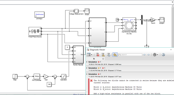

调压调速系统仿真遇到以下情况,怎么解决
910
4977
4977
发表于 2023-5-28 21:44:31 | 显示全部楼层 |阅读模式
The following two blocks cannot be connected in series because they are modeled as current sources:
Block 1: A_rotor: Asynchronous Machine SI Units
Block 2: B_rotor: Asynchronous Machine SI Units
Add a high-value resistance in parallel with one of the two block.
You can also specify high-value resistive snubbers if the blocks have a snubber device.You can also avoid the use of the snubbers by selecting the 'Enable use of ideal switching devices' option of powergui block.

电流源不能直接连,否则会电流无穷大。在电机端并联一个特别大的负载可以解决

我也遇到了这个问题,按理说电机并联个电阻应该就可以了,可是这个提示说两个SI电机不能直接相连,仿真里只有一个这个模块
