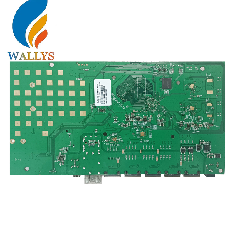

QCN9074 WiFi 6E Card,802.11ax,IPQ6010 SupportUECTEL RM500Q-GL
QCN9074/QCN9072/QCN9024 WiFi 6E Card,802.11ax,IPQ6010/IPQ6018-wallys
Qualcomm-Atheros IPQ6010
Quad-core ARM 64bit A53 @1.8GHz Processor
1GB DDRL3L System Memory
32MB NOR Flash, 256MB NAND Flash
Supports Dynamic Frequency Selection (DFS)
2x2 On-board 2.4GHz radio, up to 573Mbps physical Data Rate
2x2 On-board 5GHz radio, up to 1201Mbps physical Data Rate
Support: QUECTEL RM500Q-GL
Support: QCN9074 WiFi 6E Card
    Absolute Maximum Rating
    Parameter
    Rating
    Unit
    Supply Voltage
    24V~48
    V
    Operating Temperature Range
    -40 to +70
    oC
    Storage Temperature Range
    -45 to +105
    oC
    Operating Humidity Range
    5 to +95 (non-condensing)
    Hardware Specifications
    Symbol
    Parameter
    CPU
    CPU Frequency
    Quad-core ARM 64 bit A53 @1.8 GHz processor
    System Memory
    1GB (2x 512MB) DDR3L 16-bit interface with 32-bit memory bus design
    Ethernet Port
    1 x 1Gbps Ethernet Ports & POE3 x 1Gbps Ethernet Ports , 1x 2.5Gbps Ethernet Port
    SFP Port1x SFP port
    NGFF Slot
    M.2 (NGFF) “E Key” Socket with MiniPCIe 3.0
    SD Card Slot
    1x SD Card Slot
    USB /header
    1x USB 2.0 Port
    POE
    24V~48V passive POE/Active POE(Suport 802.3bt)
    DC Jack
    24V power supply
    LED header
    FFC/FPC Connector
    Serial Port
    1x Serial Port 4 Pin Connector
    Wireless
    On-board 2x2 2.4GHz MU-MIMO OFDMA 802.11b/g/n/ax, max 23dBm per chain
    On-board 2x2 5GHz MU-MIMO OFDMA 802.11a/n/ac/ax, max 20dBm per chain
    4 x MMCX Connectors
    BluetoothCSR8811 BLE 4.2
    Nor Flash
    32MB
    Nand Flash
    256MB
    DDR
    256MB~512MB
    Dimension
    185mm x 116mm
    Radio TX Specifications(5180MHz-5825MHz)
    Operating Mode
    Data Rate
    Power
    Tolerance
    1 Chain
    2 Chains
    5Ghz 802.11ax HE20
    MCS0
    20dBm
    23dbm
    ±2dB
    MCS1
    20dBm
    23dBm
    ±2dB
    MCS2
    20dBm
    23dBm
    ±2dB
    MCS3
    20dBm
    23dBm
    ±2dB
    MCS4
    19dBm
    22dBm
    ±2dB
    MCS5
    18dBm
    21dBm
    ±2dB
    MCS6
    17dBm
    20dBm
    ±2dB
    MCS7
    16dBm
    19dBm
    ±2dB
    MCS8
    15dBm
    18dBm
    ±2dB
    MCS9
    14dBm
    17dBm
    ±2dB
    MCS10
    13dBm
    16dBm
    ±2dB
    MCS11
    13dBm
    16dbm
    ±2dB
    5Ghz 802.11ax HE400
    MCS0
    20dBm
    23dbm
    ±2dB
    MCS1
    20dBm
    23dBm
    ±2dB
    MCS2
    20dBm
    23dBm
    ±2dB
    MCS3
    20dBm
    23dBm
    ±2dB
    MCS4
    19dBm
    22dBm
    ±2dB
    MCS5
    18dBm
    21dBm
    ±2dB
    MCS6
    17dBm
    20dBm
    ±2dB
    MCS7
    16dBm
    19dBm
    ±2dB
    MCS8
    15dBm
    18dBm
    ±2dB
    MCS9
    14dBm
    17dBm
    ±2dB
    MCS10
    13dBm
    16dBm
    ±2dB
    MCS11
    13dBm
    16dbm
    ±2dB
    5Ghz 802.11ax HE80
    MCS0
    20dBm
    23dbm
    ±2dB
    MCS1
    20dBm
    23dBm
    ±2dB
    MCS2
    20dBm
    23dBm
    ±2dB
    MCS3
    20dBm
    23dBm
    ±2dB
    MCS4
    19dBm
    22dBm
    ±2dB
    MCS5
    18dBm
    21dBm
    ±2dB
    MCS6
    17dBm
    20dBm
    ±2dB
    MCS7
    16dBm
    19dBm
    ±2dB
    MCS8
    15dBm
    18dBm
    ±2dB
    MCS9
    14dBm
    17dBm
    ±2dB
    MCS10
    13dBm
    16dBm
    ±2dB
    MCS11
    13dBm
    16dbm
    ±2dB
    Radio TX Specifications(2412MHz-2482MHz)
    Operating Mode
    Data Rate
    Power
    Tolerance
    1 Chain
    2 Chains
    2.4Ghz 802.11ax HE20
    MCS0
    23dbm
    26dbm
    ±2dB
    MCS1
    23dBm
    26dBm
    ±2dB
    MCS2
    23dBm
    26dBm
    ±2dB
    MCS3
    23dBm
    26dBm
    ±2dB
    MCS4
    23dBm
    26dBm
    ±2dB
    MCS5
    23dBm
    26dBm
    ±2dB
    MCS6
    23dBm
    26dBm
    ±2dB
    MCS7
    22dBm
    25dBm
    ±2dB
    MCS8
    21dBm
    24dBm
    ±2dB
    MCS9
    21dBm
    24dBm
    ±2dB
    MCS10
    18dBm
    21dBm
    ±2dB
    MCS11
    17dbm
    20dbm
    ±2dB
    2.4Ghz 802.11ax HE40
    MCS0
    23dbm
    26dbm
    ±2dB
    MCS1
    23dBm
    26dBm
    ±2dB
    MCS2
    23dBm
    26dBm
    ±2dB
    MCS3
    23dBm
    26dBm
    ±2dB
    MCS4
    23dBm
    26dBm
    ±2dB
    MCS5
    23dBm
    26dBm
    ±2dB
    MCS6
    23dBm
    26dBm
    ±2dB
    MCS7
    22dBm
    25dBm
    ±2dB
    MCS8
    21dBm
    24dBm
    ±2dB
    MCS9
    21dBm
    24dBm
    ±2dB
    MCS10
    21dBm
    24dBm
    ±2dB
    MCS11
    19dbm
    22dbm
    ±2dB
    GPIO Pin Mapping
    GPIO Pin Mapping
    Pin
    Signal
    Pin
    Signal
    GPIO_0
    AUDIO_MUTE_BUT
    GPIO_1
    QPIC_BUSY_N
    GPIO_2
    MIC_VOL_M
    GPIO_3
    QPIC_WE_N
    GPIO_4
    QPIC_RE_N
    GPIO_5
    QPIC_DAT4
    GPIO_6
    QPIC_DAT5
    GPIO_7
    QPIC_DAT6
    GPIO_8
    QPIC_DAT7
    GPIO_9
    WPS
    GPIO_10
    QPIC_CLE_N
    GPIO_11
    QPIC_NAND_CE_N
    GPIO_12
    QPIC_DAT1
    GPIO_13
    QPIC_DAT2
    GPIO_14
    QPIC_DAT3
    GPIO_15
    QPIC_DAT0
    GPIO_16
    MIC_KPD_PWR_N
    GPIO_17
    QPIC_ALE
    GPIO_18
    KYPD_HOME_N
    GPIO_19
    GND
    GPIO_20
    Boot_Config(PULL_DOWN)
    GPIO_21
    MUTE_ON
    GPIO_22
    ADC_RST
    GPIO_23
    WSA_SWR_CLK
    GPIO_24
    WSA_SWR_DATA
    GPIO_25
    PWM_LED_RST
    GPIO_26
    GPIO_27
    WSA_EN_R
    GPIO_28
    WSA_EN_L
    GPIO_29
    PDM_CLK0
    GPIO_30
    PDM_DATA0
    GPIO_31
    PDM_CLK1
    GPIO_32
    PDM_DATA1
    GPIO_33
    EXT_MCLK2_ADC
    GPIO_34
    MIC_VOL_P
    GPIO_35
    LED_5G
    GPIO_36
    PCIE0_WAKE
    GPIO_37
    LED_2GS
    GPIO_38
    SPI0_CLK
    GPIO_39
    SPI0_CS_NI
    GPIO_40
    SPI0_MISO
    GPIO_41
    SPI0_MOSI
    GPIO_42
    BLSP2_SCL
    GPIO_43
    BLSP2_SDA
    GPIO_44
    BLSP2_UART_RX
    GPIO_45
    BLSP2_UART_TX
    GPIO_46
    BLSP5_SCL
    GPIO_47
    BLSP5_SDA
    GPIO_48
    NC
    GPIO_49
    GPIO_50
    LED_USB0
    GPIO_51
    BT_PRIORITY_PTA11
    GPIO_52
    WLA_ACTI_PTA12
    GPIO_53
    BT_ACT_PTA10
    GPIO_54
    GPIO_55
    NC
    GPIO_56
    NC
    GPIO_57
    NC
    GPIO_58
    NC
    GPIO_59
    PCIE0_CLK_REQ
    GPIO_60
    PCIE0_RSTn
    GPIO_61
    NC
    GPIO_62
    SD_DET
    GPIO_63
    SD_WP
    GPIO_64
    MDC
    GPIO_65
    MDIO
    GPIO_66
    SD_LDO_EN
    GPIO_67
    NC
    GPIO_68
    NC
    GPIO_69
    SPI_CLK_UART_RTSn
    GPIO_70
    SPI_CS_UART_CTSn
    GPIO_71
    SPI_MISO_UART_RX
    GPIO_72
    SPI_MOSI_UART_TX
    GPIO_73
    USB_OTG
    GPIO_74
    NC
    GPIO_75
    Malibu_RESET
    GPIO_76
    NAPA_INT0
    GPIO_77
    NAPA_RESET
    GPIO_78
    QTZ_INT
    GPIO_79
    QTZ_RESET
    Boot Config Switch
    Boot_Config Switch1(S7)
    Boot_Config
    Boot up InterfaceSelect
    S7A
    S7B
    S7C
    SPI NOR. (Default)
    eMMC
    QPIC, Parallel NAND
    USB2.0
    SPI-NOR-GPT
    S7D
    Boot from code ram.(Default)
    Boot from ROM
    Boot_Config Switch2(S9)
    Boot_Config
    No auth.(Default)
    Auth is required
