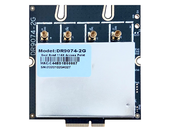

QCN9074/QCN9024/QCN6024  802.11ax 4x4 MU-MIMO 2.4GHz wifi6-wallys
■ Qualcomm Atheros QCN9074
■ 2.4GHz, max 23dBm per chain, up to 1147Mbps
■ Single Band 2.4GHz 4x4 WiFi 6 (802.11ax
■ 4 spatial streams (4SS)
■ M.2 E Key Interface
■ PCI Express 3.0 Interface
    Absolute Maximum Rating
    Parameter
    Rating
    Unit
    Operating Temperature Range
    -20 to 70
    oC
    Storage Temperature Range
    -40 to 90
    oC
    Operating Humidity Range
    5 to +95 (non-condensing)
    Storage Humidity Range
    0 to +90 (non-condensing)
    Hardware Specifications
    Symbol
    Parameter
    Chipset
    WLAN Host Interface
    System Memory
    2Mbit serial I2C bus EEPROM
    Standard Operating Voltage
    5V
    Operating Systems
    QSDK
    Host Interface
    M.2 E Key
    Antenna Cable / Port
    4 x MMCX Connectors,4T4R
    Frequency Range
    2.412GHz-2.472GHz
    Data Rates for WALN
    2.4GHz, max 23dBm per chain, up to 4949Mbps
    Channel Spectrum Widths for WLAN
    Support 20/40MHz at 2.4GHz
    Modulation Techniques
    OFDMA: BPSK, QPSK, DBPSK, DQPSK,16-QAM, 64-QAM, 256-QAM,1024-QAM
    Temperature Range
    Operating: -20°C to 70°C, Storage: -40°C to 90°C
    Humidity
    Operating: 5% to 95% (non-condensing), Storage: Max. 90% (non-condensing)
    Certification
    TBD
    Power Consumption
    TBD
    Reference Design
    PN01.1
    Dimensions (WxHxD)
    57mm x 63mm x 6mm
      M.2 Pin Definitions
