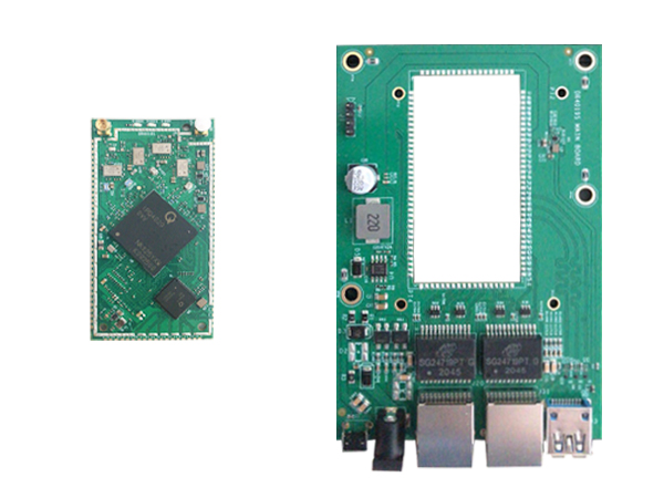

IPQ4019 openWRT 802.11ac wifi5 2.4/5G dual bands -wallys
Featuring withindustrial-grade IPQ4019  chipset
Integrated with 2x 2 5G high power
Radio module and 2x2 2.4G high power  Radio module
Support 5.180GHz to5.825GHz Frequency Range;
Support 2.412GHz to 2.482GHz
Support 2 x 5G MMCX Connectors and 2x2.4G MMCX
20MHz/40MHz/80MHz Bandwidth
Support 11ABGN/802.11AC
RoHS compliance ensure a high level
protection of human health and the environment from risks that can be posed by
    Absolute Maximum Rating
    Parameter
    Rating
    Unit
    Supply Voltage
    24V~48
    V
    Operating Temperature Range
    -40 to +70
    oC
    Storage Temperature Range
    -45 to +105
    oC
    Operating Humidity Range
    5 to +95 (non-condensing)
    Storage Humidity Range
    0 to +90 (non-condensing)
    Hardware Specifications
    Symbol
    Parameter
    CPU
    IPQ4019(Quad core ARM Cortex A7 at 716.8 MHz)
    Antenna Connector
    2 x 5G MMCX connectors;2x2.4G MMCX
    10/100/1000Mbps
         Gigabit Ethernet
    2xRJ45
    DC Jack
    12 power supply
    ROHS Compliance
    YES
    Dimension
    65mmx35mm x 16mm
    Max Power
    12V x 0.8A= 9.6W
    Nor Flash
    32MB
    DDR
    256MB
    Radio TX Specifications(5180MHz-5825MHz)
    Operating Mode
    Data Rate
    Power
    Tolerance
    1 Chain
    2 Chains
    802.11a
    6 Mbps
    26dBm
    29dbm
    ±2dB
    54 Mbps
    22dBm
    25dbm
    ±2dB
    802.11n HT20
    MCS0, MCS8
    26dBm
    29dbm
    ±2dB
    MCS7, MCS15
    22dBm
    25dbm
    ±2dB
    802.11n HT40
    MCS0, MCS8
    25dBm
    28dbm
    ±2dB
    MCS7, MCS15
    21dBm
    24dbm
    ±2dB
    802.11ac
    MCS0, MCS10,MCS20
    25dBm
    28dbm
    ±2dB
    MCS9,MCS19,MCS29
    19dBm
    22dbm
    ±2dB
    Radio RX Specifications(5180MHz-5825MHz)
    Operating Mode
    Data Rate
    Sensitivity
    802.11a
    6 Mbps
    -92dBm
    54 Mbps
    -74dBm
    802.11n HT20
    MCS0, MCS8
    -91dBm
    MCS7, MCS15
    -72dBm
    802.11n HT40
    MCS0, MCS8
    -90dBm
    MCS7, MCS15
    -70dBm
    802.11AC  HT40
    MCS0, MCS10,MCS20
    -90dBm
    MCS9,MCS19,MCS29
    -67dBm
    802.11AC  HT80
    MCS0, MCS10,MCS20
    -88dBm
    MCS9,MCS19,MCS29
    -62dBm
    Radio TX Specifications(2412MHz-2482MHz)
    Operating Mode
    Data Rate
    Power
    Tolerance
    1 Chain
    2 Chains
    802.11g
    6 Mbps
    25dbm
    28dbm
    ±2dB
    54 Mbps
    22dbm
    25dbm
    ±2dB
    802.11n HT20
    MCS0, MCS8
    25dbm
    28dbm
    ±2dB
    MCS7, MCS15
    21dbm
    24dbm
    ±2dB
    802.11n HT40
    MCS0, MCS8
    25dbm
    28dbm
    ±2dB
    MCS7, MCS15
    21dbm
    24dbm
    ±2dB
    Radio RX Specifications(2412MHz-2482MHz)
    Operating Mode
    Data Rate
    Sensitivity
    802.11g
    6 Mbps
    -91dBm
    54 Mbps
    -73dBm
    802.11n HT20
    MCS0, MCS8
    -90dBm
    MCS7, MCS15
    -72dBm
    802.11n HT40
    MCS0, MCS8
    -90dBm
    MCS7, MCS15
    -70dBm
