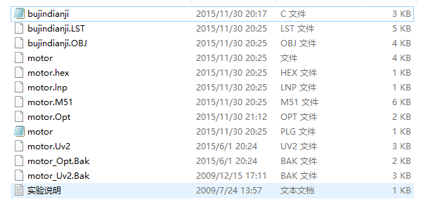

单片机C语言实例-382-步进电机
#include <reg52.h>       //51芯片管脚定义头文件
#include <intrins.h>       //内部包含延时函数 _nop_();
#define uchar unsigned char
#define uint  unsigned int
sbit  K1=P1^2;
uchar code FFW[8]={0xf1,0xf3,0xf2,0xf6,0xf4,0xfc,0xf8,0xf9};
uchar code REV[8]={0xf9,0xf8,0xfc,0xf4,0xf6,0xf2,0xf3,0xf1};
uchar rate ;
/* 延时
/* 11.0592MHz时钟,
void delay()
   uchar k;
   uint s;
   k = rate;
   do
       for(s = 0 ; s <125 ; s++) ;
    }while(--k);
/*步进电机正转
void  motor_ffw()
   uchar i;
   uint  j;
   for (j=0; j<16; j++)         //转1*n圈
                         //退出此循环程序
      for (i=0; i<8; i++)       //一个周期转45度
          P0 = FFW;          //取数据
          delay();            //调节转速
*步进电机运行
void  motor_turn()
   uchar x;
   rate=0x10;
   x=0x0f;
   do
        motor_ffw();               //加速
        rate--;
     }while(rate!=0x02);
   do
        motor_ffw();               //匀速
       x--;
     }while(x!=0x01);
   do
        motor_ffw();              //减速
        rate++;
     }while(rate!=0x0a);
*  主程序
main()
   P0=0x0f;
   while(1)
      P0=0x0f;
      if(K1==0)
       motor_turn();
更多详情参考附件文档
