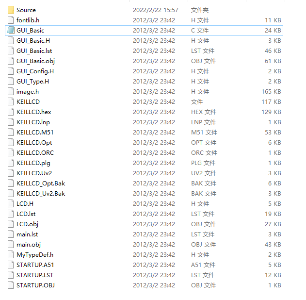

单片机C语言实例-205-彩屏图片显示
File Name : GUI_Basic.c
Author    : LiYOng
Date      : 2008-12-12 15:51
Version   : 1.0
Decription: This file contains some basic functions for GUI, It need the LCD
            Drive functions
#include "GUI_Basic.H"

更多详情参考附件文档
