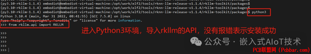

    4、可以执行以下命令,进入Python3,然后导入rkllm的API接口,如果命令没有报错,则表示虚拟机Ubuntu22.04的rkllm_toolkit环境搭建成功。" A7 x4 P: e2 ]3 C  U9 F
    - x' ]) K% l9 E* q  v# V
    4 l6 _; I5 e: e% `) F( z0 a

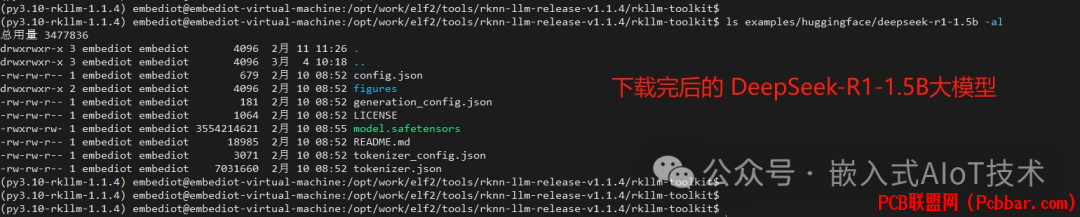

    0 [- @4 P* J9 T) I  R5、先安装huggingface-cli工具,这是一个huggingface大模型下载的客户端工具,在conda虚拟环境中执行以下命令:
      y% K; P) R: f) s
  • pip3 install huggingface-cli -i https://mirrors.huaweicloud.com/repository/pypi/simple4 o  o, ?; f. b( Y( v, [
    6、在rknn-llm-release-v1.1.4/rkllm-toolkit/examples/目录下新建一个huggingface文件夹,然后把DeepSeek-R1-1.5B的模型下载到此目录下,执行以下命令。+ R5 ?& @% a0 [
  • mkdir rknn-llm-release-v1.1.4/rkllm-toolkit/examples/huggingface -pcd rknn-llm-release-v1.1.4/rkllm-toolkit/examples/huggingfaceexport HF_ENDPOINT=https://hf-mirror.comhuggingface-cli download deepseek-ai/DeepSeek-R1-Distill-Qwen-1.5B --local-dir . --local-dir-use-symlinks False# p% W8 |& Y5 S+ @0 D
    7、上一步配置的HF_ENDPOINT环境变量,会使用国内的加速节点进行下载,但有时候也会下载失败,有时候直接在官网点击下载链接会更快,也可以搜索一下网上的网盘,也有该模型提供,模型下载完成后,如下图所示。$ O4 B8 Q9 z9 U$ M7 E, \0 l

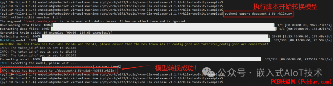

    8、创建一个Python脚本,名为“export_deepseek_1.5b_rkllm.py”,并且把该脚本放在rkllm-toolkit/examples/目录下,脚本的内容如下。
    2 }( v/ V  K" {# J( t' m
  • from rkllm.api import RKLLMimport os#os.environ['CUDA_VISIBLE_DEVICES']='0'modelpath = './huggingface/deepseek-r1-1.5b'llm = RKLLM()# Load model# Use 'export CUDA_VISIBLE_DEVICES=0' to specify GPU device# options ['cpu', 'cuda']ret = llm.load_huggingface(model=modelpath, model_lora = None, device='cpu')if ret != 0:    print('Load model failed!')    exit(ret)# Build modeldataset = "./data_quant.json"qparams = Noneret = llm.build(do_quantization=True, optimization_level=1, quantized_dtype='w8a8',                quantized_algorithm='normal', target_platform='rk3588', num_npu_core=3,                extra_qparams=qparams,dataset=dataset)if ret != 0:    print('Build model failed!')    exit(ret)# Export rkllm modelret = llm.export_rkllm(f"./deepseek-1.5b-w8a8-rk3588.rkllm")if ret != 0:    print('Export model failed!')    exit(ret)
    6 I" I- c& Y% R
    3 l0 _* v* c) Y. |/ p, t) o* J9、在rkllm-toolkit/examples/目录下还需要一个data_quant.json文件,这个文件在网上可以搜索到,关于export_deepseek_1.5b_rkllm.py文件和data_quant.json文件,也可以联系我这边获取。" b6 H5 s* C5 V3 \& O' o/ q- `
    ' b( i" G: F( K7 q5 @6 N/ c& c$ a8 Y
    10、在conda虚拟环境下,执行以下命令,开始把DeepSeek-R1-1.5B模型转换为rkllm格式的模型,& b* f" K: ?" ?; q. o1 G
  • python3 export_deepseek_1.5b_rkllm.py
    - m/ G" i' h! ~( d/ j模型转换成功后,如下图所示。

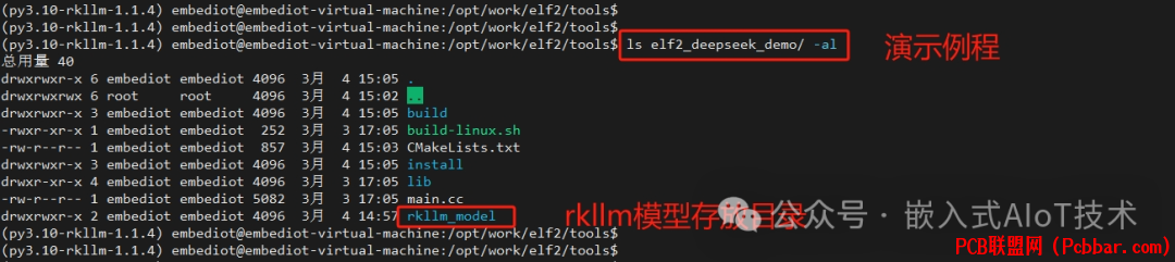

    12、创建一个例程elf2_deepseek_demo,这个例程在开发板的Ubuntu22.04上运行,把上一步转换成功的.rkllm模型,复制到例程的rkllm_model文件夹里面,然后执行./build-linux.sh脚本进行编译。
    4 s& G* B9 ?) y' k
    ' B( S8 G9 A) v0 n% D7 q7 s注意:编译前要确保已经搭建好ELF2的交叉编译环境。% l$ B! \" {- n& ]4 I
    5 k# S2 u6 _8 N! h9 t/ i/ M3 l& [
    3 r2 o9 v. o3 e; i9 J
    (应用程序源码请后台联系作者获取)
    5 G9 v7 H( _( r+ P- {& l/ X: ?" F7 m: }* M8 q: r8 q- E
    13、编译成功后,可执行文件存放在install/elf2_deepseek_rkllm_demo目录下,把elf2_deepseek_rkllm_demo文件夹上传到ELF2开发板,此外,还需要把一些动态库上传到开发板的usr/lib目录。
