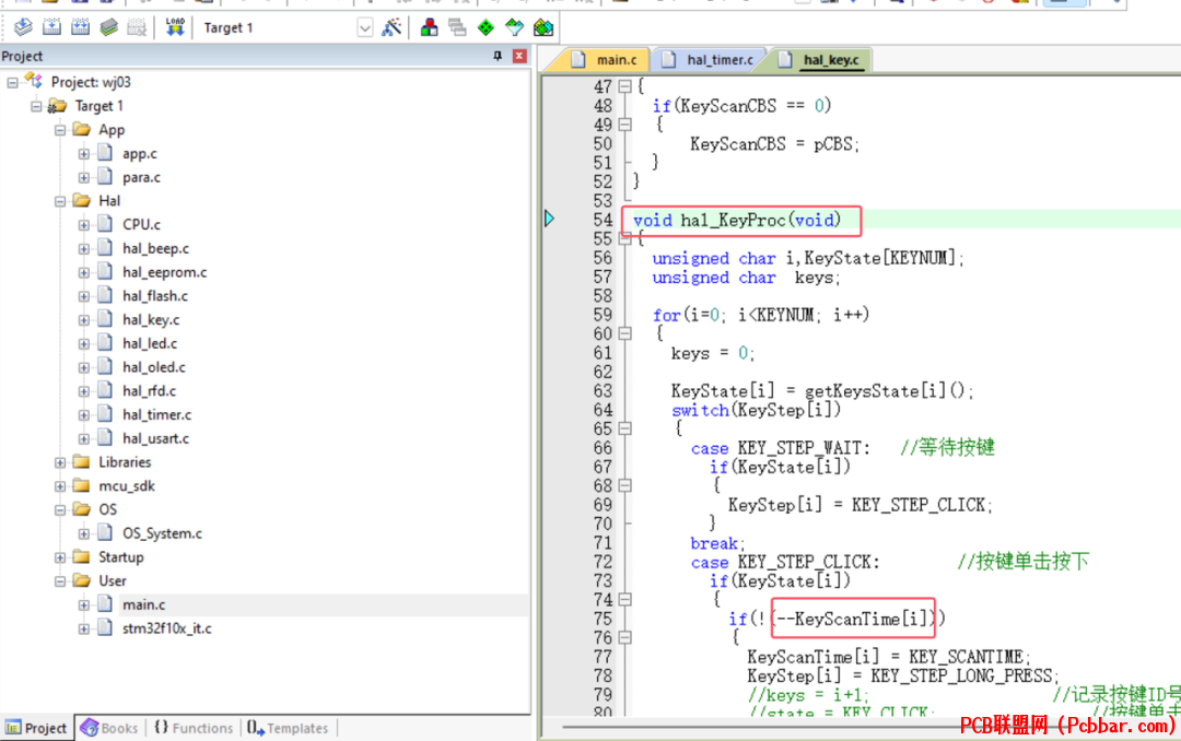

    3.2 按键消抖(进阶用法)
  • #define KEY_TASK_ID 1uint8_t key_state = 0;void Key_Scan_Task(void){    static uint16_t press_time = 0;        if(GPIO_ReadInputDataBit(GPIOA,GPIO_Pin_0)){        if(++press_time > 10){ // 50μs*10=0.5ms            key_state = 1;        }    }else{        press_time = 0;        key_state = 0;    }}void Init_Key_Scan(void){    hal_CreatTimer(KEY_TASK_ID, Key_Scan_Task, 10, T_STA_START); // 每0.5ms扫描}
