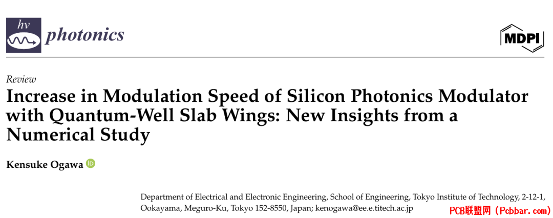

' l  h& \% g9 L+ W[1] K. Ogawa, "Increase in Modulation Speed of Silicon Photonics Modulator with Quantum-Well Slab Wings: New Insights from a Numerical Study," Photonics, vol. 11, no. 535, Jun. 2024, doi: 10.3390/photonics11060535.
