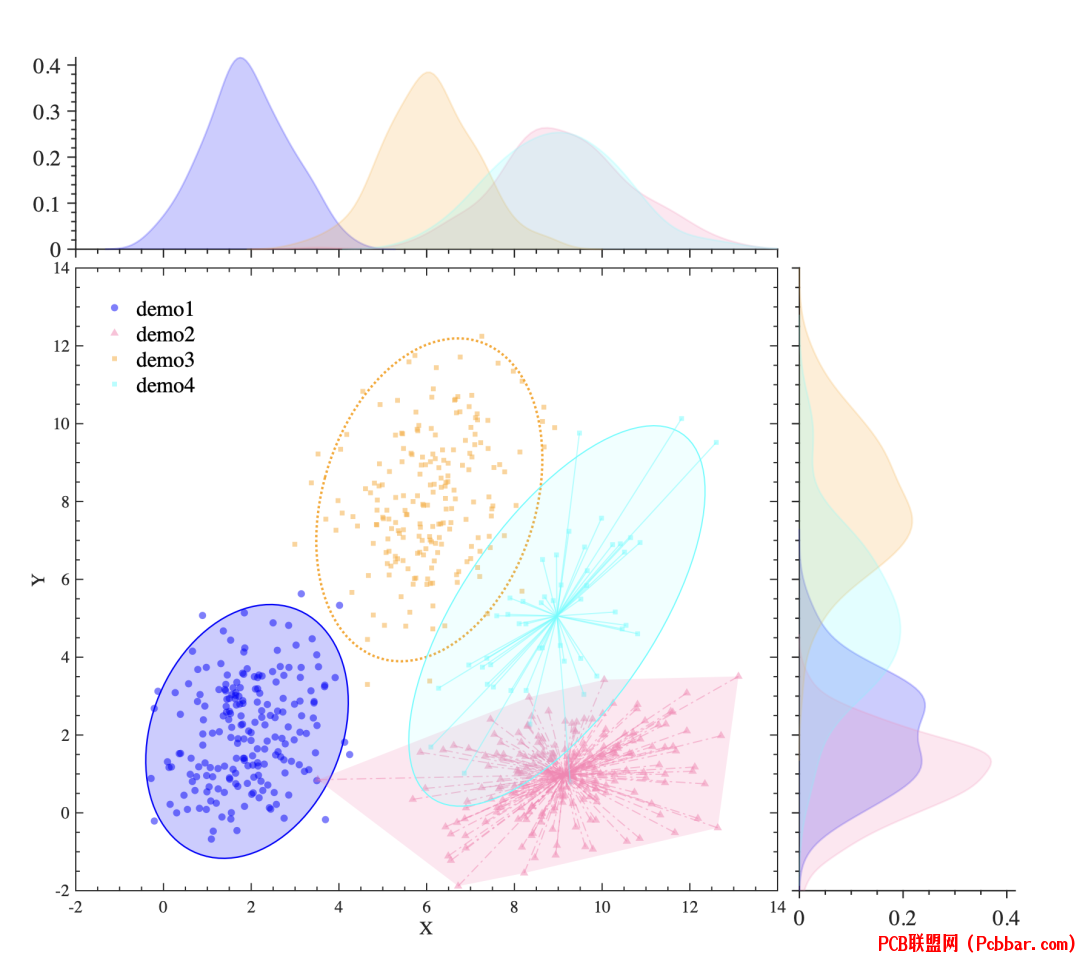

前几天介绍了Matlab绘制炫酷的聚类散点图,今天介绍一下聚类散点图添加边际图的核密度填充图,喜欢此推文的小伙伴们记得点赞+关注+分享!【尊重作者劳动成果,转载请注明推文链接和公众号名】
效果图

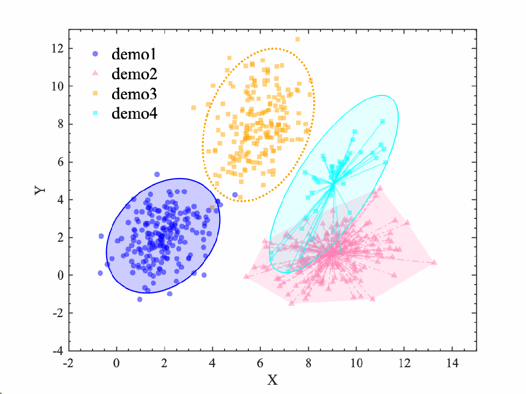

先运行之前推文的炫酷的聚类散点图的代码。
  • clc;clear;close all;%--------------------------------------------------------------------------% @Author: 好玩的Matlab% @公众号:好玩的Matlab% @Created: 09,02,2023% @Email:2377389590@qq.com% @Disclaimer: This code is provided as-is without any warranty.%--------------------------------------------------------------------------
    d1=repmat([2 2],200,1) + randn(200,2)*[1 .5; 0 1.32];d2=repmat([9 1],200,1) + randn(200,2)*[1.4 0.2; 0 0.98];d3=repmat([6 8],200,1) + randn(200,2)*[1 0.5; 0  1.7];d4=repmat([9 5],50,1) + randn(50,2)*[1 0.7; 0.5  2];% 使用scatter函数绘制散点图hold onsh1=scatter(d1(:,1), d1(:,2),'filled','CData',[0,0,1],'MarkerFaceAlpha',0.5,'MarkerEdgeColor','none','Marker','o');sh2=scatter(d2(:,1), d2(:,2),'filled','CData',[1, 0.5, 0.7],'MarkerFaceAlpha',0.5,'MarkerEdgeColor','none','Marker','^');sh3=scatter(d3(:,1), d3(:,2),'filled','CData',[1,0.6471,0],'MarkerFaceAlpha',0.5,'MarkerEdgeColor','none','Marker','s');sh4=scatter(d4(:,1), d4(:,2),'filled','CData',[0,1,1],'MarkerFaceAlpha',0.5,'MarkerEdgeColor','none','Marker','s');
    confidenceLevel=0.95;ell1 = ConfidenceEllipse(sh1,d1, confidenceLevel);ell1.PlotType = 'fill';ell1.plotEllipse();
    viz2 = ClusterViz(sh2, d2);viz2.PlotType='fill';viz2.clusterViz();
    ell3 = ConfidenceEllipse(sh3,d3, confidenceLevel);ell3.PlotType = 'line';ell3.LineStyle=':';ell3.LineWidth=2;ell3.FillAlpha=1;ell3.plotEllipse();
    ell4 = ConfidenceEllipse(sh4,d4, confidenceLevel);ell4.PlotType = 'fill';ell4.LineStyle='-';ell4.LineWidth=1;ell4.FillAlpha=0.1;ell4.plotEllipse();
    viz4 = ClusterViz(sh4, d4);viz4.PlotTypeState='off';viz4.Color=[0,1,1];viz4.LineStyle='-';viz4.clusterViz();legend('demo1','demo2','demo3','demo4','box','off','Location','best','fontsize',18)% 设置轴标签和标题defaultAxes
    其中defaultAxes是修饰Axes属性的,因为经常重复调用,我写成了函数方便调用。
  • function defaultAxesax=gca;box on% ax.XLim=[-2,15];% ax.YLim=[-4,13];ax.XLabel.String='X';ax.YLabel.String='Y';ax.Title.String='';ax.FontName='Times New Roman';
    ax.GridLineStyle = '-.'; % 设置网格线样式为虚线ax.GridColor = 'k'; % 设置网格线颜色为红色ax.XGrid = 'off'; % 关闭X轴网格线ax.YGrid = 'off';  % 打开Y轴网格线
    ax.LineWidth = 1;            % 设置坐标轴线宽ax.XMinorTick = 'on';        % 打开x轴次要刻度线ax.YMinorTick = 'on';        % 打开y轴次要刻度线ax.TickDir = 'in';           % 设置刻度线方向向外ax.FontSize = 14;            % 设置坐标轴字体大小end其中PlotDensFill绘制边际图的核密度图代码如下。
  • classdef PlotDensFill    %--------------------------------------------------------------------------    % @Author: 好玩的Matlab    % @公众号:好玩的Matlab    % @Created: 09,02,2023    % @Email:2377389590@qq.com    % @Disclaimer: This code is provided as-is without any warranty.    %--------------------------------------------------------------------------
        properties        XData;  %x数据        YData;  %y数据        FillColor %填充颜色        LineColor %线条颜色        FaceAlpha %透明度数        LineStyle %线条样式        LineWidth %线条宽度        LineMarker %标记符号        HFig    end    methods        function obj  = PlotDensFill(sHdl)            % 设置默认参数            obj.XData=get(sHdl,'XData');            obj.YData=get(sHdl,'YData');            obj.FillColor=get(sHdl,'CData');            obj.FaceAlpha = get(sHdl,'MarkerFaceAlpha')*0.4;            obj.LineColor = get(sHdl,'CData');            obj.LineStyle='-';            obj.LineWidth=1.5;            obj.LineMarker='none';            obj.HFig=gcf;        end
            function plotDensFill(obj)            hFig = obj.HFig;  % 获取当前figure的句柄            axesPositions ={[0.07,0.07,0.65,0.65],...   % 主图                [0.07,0.07,0.65,0.65],...               % 与主图重合                [0.07,0.74,0.65,0.2],...                % 顶部区域                [0.74,0.07,0.2,0.65]};                 % 右侧区域
                axObj=findall(hFig, 'Type', 'axes');            hFig.Position=[439 76 891 790];            axesCount = length(axObj);            % axesCount = length(findall(gcf, 'Type', 'axes'));            if axesCount==1                ax=gca;                ax.Box='on';                ax.Position=axesPositions{1};                topAxes = axes('position', axesPositions{3});                rightAxes = axes('position', axesPositions{4});            end            % 遍历所有 Axes 对象            for i = 1:length(axObj)                ax = axObj(i);  % 获取当前 Axes 对象                pos = get(ax, 'Position');  % 获取当前 Axes 对象的 Position 属性                % 检查 Position 是否匹配                if sum(abs(pos- axesPositions{1}))                    mainAxes=ax;                elseif  sum(abs(pos- axesPositions{3}))                    topAxes = ax;                elseif sum(abs(pos- axesPositions{4}))                    rightAxes = ax;                end            end            %核密度计算            [fx,xi] = ksdensity(obj.XData);            [fy,yi] = ksdensity(obj.YData);            % 这里绘制到topAxes            if ~isempty(topAxes)                axes(topAxes);                hold on;                %上图核密度曲线                fill(topAxes, [0,xi,fliplr(xi),0], [0,fx, zeros(1,length(fx)), 0],obj.FillColor, 'FaceAlpha', obj.FaceAlpha,'EdgeColor','none');                topAxes.YDir='normal';                topAxes.XMinorTick = 'on';                topAxes.YMinorTick = 'on';                topAxes.TickDir = 'out';                topAxes.TickLength=[.011 .01];                topAxes.XTickLabel={};                topAxes.Visible='on';                topAxes.Box='off';                topAxes.LineWidth=1.2;                topAxes.FontSize=18;                topAxes.FontName='Times New Roman';                topAxes.XLim=ax.XLim;                topAxes.Box='off';                line(topAxes,xi,fx,'color',[obj.LineColor,obj.FaceAlpha],'LineStyle',obj.LineStyle,'Linewidth',obj.LineWidth,'Marker',obj.LineMarker);                text(topAxes,topAxes.XLim(2) + abs(topAxes.XLim(2) - topAxes.XLim(1)) * 0.05, mean(topAxes.XLim), 'Top-Label', 'HorizontalAlignment', 'center',...                    'VerticalAlignment', 'middle', 'Rotation', 90,'FontSize',18);
                end            % 这里绘制到rightAxes            if ~isempty(rightAxes)                axes(rightAxes);                hold on;                %右边图核密度曲线                fill(rightAxes,[0, fy, zeros(1,length(fy)), 0], [0, yi, fliplr(yi), 0],  obj.FillColor, 'FaceAlpha',obj.FaceAlpha,'EdgeColor','none');                rightAxes.YDir='normal';                rightAxes.XMinorTick = 'on';                rightAxes.YMinorTick = 'on';                rightAxes.TickDir = 'out';                rightAxes.TickLength=[.011 .01];                rightAxes.YTickLabel={};                rightAxes.Visible='on';                rightAxes.Box='off';                rightAxes.LineWidth=1.2;                rightAxes.FontSize=18;                rightAxes.FontName='Times New Roman';                rightAxes.XLim=topAxes.YLim;                rightAxes.YLim=ax.YLim;                rightAxes.Box='off';                line(rightAxes,fy,yi,'color',[obj.LineColor,obj.FaceAlpha],'LineStyle',obj.LineStyle,'Linewidth',obj.LineWidth,'Marker',obj.LineMarker);
                end            % 绑定X Y            linkaxes([mainAxes,rightAxes],'y')            linkaxes([mainAxes,topAxes],'x')        end
        endend其中参数为:
    XData x数据 YData  y数据 FillColor 填充颜色 LineColor 线条颜色 FaceAlpha 透明度数 LineStyle 线条样式 LineWidth 线条宽度 LineMarker 标记符号
    调用方式如下
    然后运行关于PlotDensFill绘制边际图的核密度图代码。
  • disp('按回车键继续运行代码')pausePhdl1=PlotDensFill(sh1);%设置填充的颜色和透明色% Phdl1.FillColor='k';% Phdl1.FaceAlpha=0.5;% % 设置线条的 格式,颜色,粗细% Phdl1.LineStyle=':';% Phdl1.LineColor='b';% Phdl1.LineWidth=2;% Phdl1.LineMarker='none';Phdl1.plotDensFill();
    Phdl2=PlotDensFill(sh2);% Phdl2.LineStyle='--';% Phdl2.LineColor='r';% Phdl2.LineWidth=2;% Phdl2.LineMarker='none';Phdl2.plotDensFill();
    Phdl3=PlotDensFill(sh3);% Phdl3.LineStyle='-.';% Phdl3.LineColor='y';% Phdl3.LineWidth=2;% Phdl3.LineMarker='none';Phdl3.plotDensFill();
    Phdl4=PlotDensFill(sh4);Phdl4.plotDensFill();disp('运行结束')

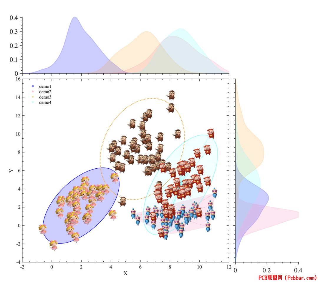

    图片散点图添加边际图
    之前的图片散点图也可以添加边际图
    d1=repmat([2 2],40,1) + randn(40,2)*[1 .5; 0 1.32];d2=repmat([9 1],40,1) + randn(40,2)*[1.4 0.2; 0 0.98];d3=repmat([6 8],40,1) + randn(40,2)*[1 0.5; 0  1.7];d4=repmat([9 5],40,1) + randn(40,2)*[1 0.7; 0.5  2];% 使用scatter函数绘制散点图hold onsh1=scatter(d1(:,1), d1(:,2),'filled','CData',[0,0,1],'MarkerFaceAlpha',0.5,'MarkerEdgeColor','none','Marker','o');sh2=scatter(d2(:,1), d2(:,2),'filled','CData',[1, 0.5, 0.7],'MarkerFaceAlpha',0.5,'MarkerEdgeColor','none','Marker','^');sh3=scatter(d3(:,1), d3(:,2),'filled','CData',[1,0.6471,0],'MarkerFaceAlpha',0.5,'MarkerEdgeColor','none','Marker','s');sh4=scatter(d4(:,1), d4(:,2),'filled','CData',[0,1,1],'MarkerFaceAlpha',0.5,'MarkerEdgeColor','none','Marker','s');% 设置置信区间confidenceLevel=0.95;ell1 = ConfidenceEllipse(sh1,d1, confidenceLevel);ell1.PlotType = 'fill';ell1.plotEllipse();viz1 = ClusterViz(sh1, d1);viz1.PlotTypeState='on';
    coef=ones(1,length(d1))*3;plotImageScatter(d1(:,1), d1(:,2), 'pic/猪猪侠/2.png', coef); % 调用函数来绘制图像散点图plotImageScatter(d2(:,1),d2(:,2), 'pic/猪猪侠/3.png', coef); % 调用函数来绘制图像散点图plotImageScatter(d3(:,1),d3(:,2), 'pic/猪猪侠/4.png', coef); % 调用函数来绘制图像散点图plotImageScatter(d4(:,1),d4(:,2), 'pic/猪猪侠/5.png', coef); % 调用函数来绘制图像散点图
    legend('demo1','demo2','demo3','demo4','box','off','Location','best')% 设置轴标签和标题defaultAxes
    Phdl1=PlotDensFill(sh1);%设置填充的颜色和透明色% Phdl1.FillColor='k';% Phdl1.FaceAlpha=0.5;% 设置线条的 格式,颜色,粗细% Phdl1.LineStyle=':';% Phdl1.LineColor='b';% Phdl1.LineWidth=2;% Phdl1.LineMarker='none';Phdl1.plotDensFill();
