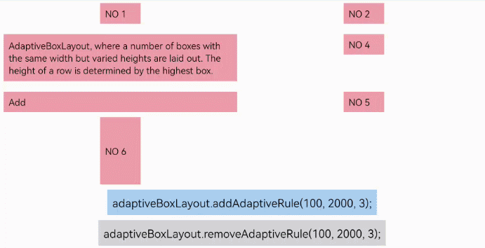

    8 z! H6 l. |+ l! U/ A2 x在AdaptiveBox Layout中添加和删除自适应盒子布局规则的效果对比如下。6 {# \# \# u. c+ [9 ?# V( o: \, c, `
    : u( p. l3 m9 o8 \
    3 L, m& z, m/ n! Q, h" o/ `" H* C+ F8 n4 M; ~
    XML布局示例代码:; Q/ I4 L5 @! X0 A
    ( d& y3 i+ h+ e! j
  • xmlns:ohos="http://schemas.huawei.com/res/ohos"    ohos:height="match_parent"    ohos:width="match_parent"    ohos:orientation="vertical">
    8 U0 g) K# }+ g, B( L, L3 G" {    xmlns:ohos="http://schemas.huawei.com/res/ohos"        ohos:height="0vp"        ohos:width="match_parent"        ohos:weight="1"        ohos:id="$+id:adaptive_box_layout">; M5 z/ y3 Y3 O# l5 K
    7 G: n: e) z& d# ?& D5 WJava关键代码:! B1 M. M" b# @
    1 ~2 u6 A2 @5 F7 T2 M6 n
  • AdaptiveBoxLayout adaptiveBoxLayout = (AdaptiveBoxLayout)findComponentById(ResourceTable.Id_adaptive_box_layout);7 b( V8 f* t6 q# G
    findComponentById(ResourceTable.Id_add_rule_btn).setClickedListener((component-> {    // 添加规则    adaptiveBoxLayout.addAdaptiveRule(100, 2000, 3);    // 更新布局    adaptiveBoxLayout.postLayout();}));
    ' h7 V# W" @5 @9 EfindComponentById(ResourceTable.Id_remove_rule_btn).setClickedListener((component-> {    // 移除规则    adaptiveBoxLayout.removeAdaptiveRule(100, 2000, 3);    // 更新布局    adaptiveBoxLayout.postLayout();}));2 m6 s' L1 ?2 b0 ~
