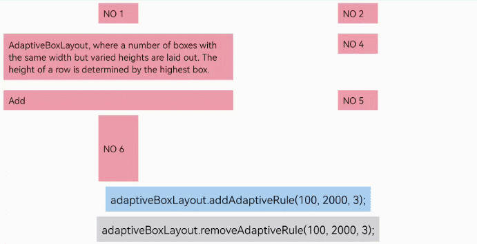

    在AdaptiveBox Layout中添加和删除自适应盒子布局规则的效果对比如下。
    9 W+ G4 P1 n! a" B6 j( \  X" d$ k' `
    ; h! N& D( w5 v8 v* C( v
    % ]' {* U3 ^2 z0 A3 b
    7 w3 [3 L8 c2 O0 V% v. {' QXML布局示例代码:! r/ E! V+ R. @; S" t1 r$ a
    6 I* T$ K6 o( }; [7 _# v! ]
  • xmlns:ohos="http://schemas.huawei.com/res/ohos"    ohos:height="match_parent"    ohos:width="match_parent"    ohos:orientation="vertical">1 I. n" B) Q, Y: z- B  O3 O9 r) O0 @
        xmlns:ohos="http://schemas.huawei.com/res/ohos"        ohos:height="0vp"        ohos:width="match_parent"        ohos:weight="1"        ohos:id="$+id:adaptive_box_layout">
    5 C9 c9 d2 \) C" F
    ; W; {: O5 b' S0 |% v# y3 b. tJava关键代码:7 u  V8 i/ J4 j3 L7 Y
    ' l  m( I! J+ N" j8 H: a
  • AdaptiveBoxLayout adaptiveBoxLayout = (AdaptiveBoxLayout)findComponentById(ResourceTable.Id_adaptive_box_layout);1 ?0 t' j  G4 l# s% \2 J
    findComponentById(ResourceTable.Id_add_rule_btn).setClickedListener((component-> {    // 添加规则    adaptiveBoxLayout.addAdaptiveRule(100, 2000, 3);    // 更新布局    adaptiveBoxLayout.postLayout();}));
    / D1 y- Y4 b0 {1 I3 ofindComponentById(ResourceTable.Id_remove_rule_btn).setClickedListener((component-> {    // 移除规则    adaptiveBoxLayout.removeAdaptiveRule(100, 2000, 3);    // 更新布局    adaptiveBoxLayout.postLayout();}));% `1 K4 u* m: Z% P
