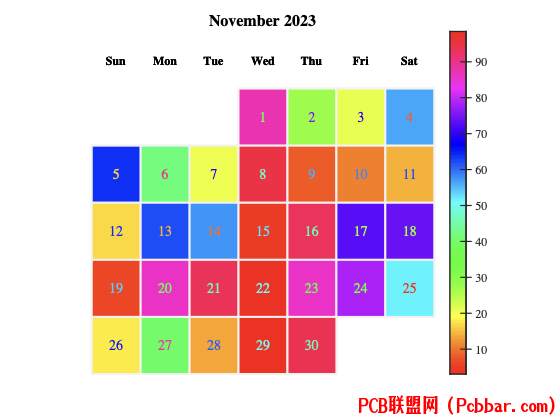

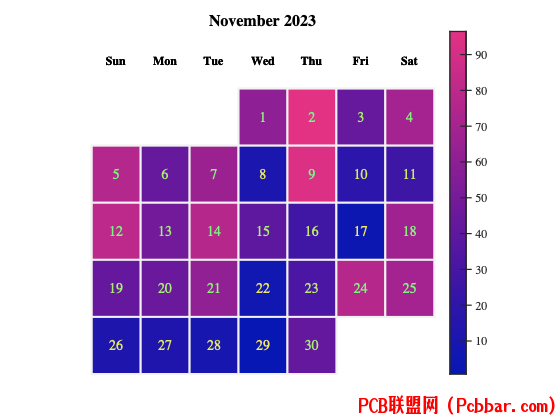

    使用方法默认方法
  • year=2023;month=11;data=rand(eomday(year,month),1)*100;P=HeatmapCalendar('Data',data,'Year',year,'Month',month);

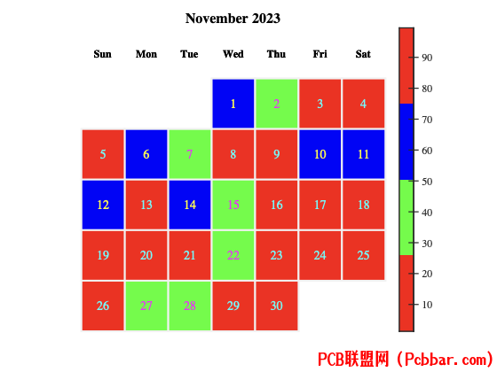

    设置颜色数据量
  • year=2023;month=11;data=rand(eomday(year,month),1)*100;P=HeatmapCalendar('Data',data,'Year',year,'Month',month);P.CMapNum=4;P.plot();

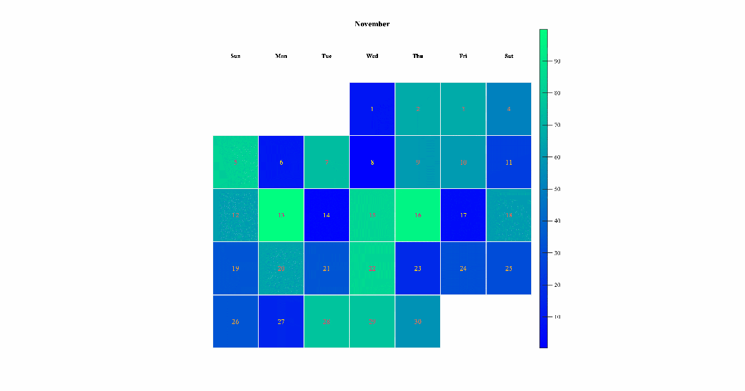

    设置不同的颜色条类型
  • year=2023;month=11;data=rand(eomday(year,month),1)*100;P=HeatmapCalendar('Data',data,'Year',year,'Month',month);P.Colormap=winter;P.plot();
    自定义颜色条
  • year=2023;month=11;data=rand(eomday(year,month),1)*100;P=HeatmapCalendar('Data',data,'Year',year,'Month',month);P.Colormap=winter;P.Colormap=[0.0078, 0.0941, 0.7333; 0.9725, 0.0039, 0.5216];P.plot();

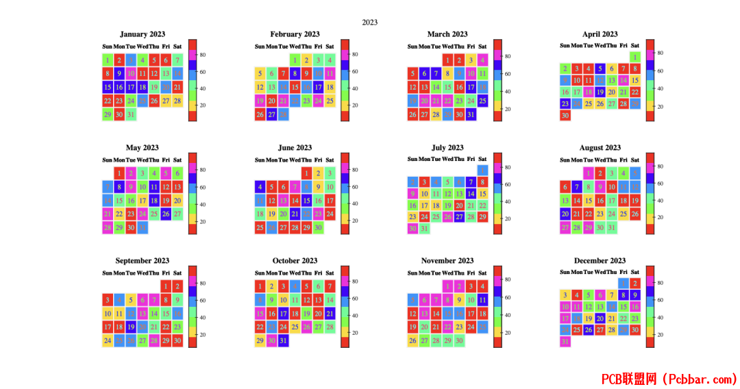

    全年每月设置相同的颜色条类型
  • clc; close all; clear;figure('Position',[1 72 1512 794])year=2023;colormapList={parula,turbo,hsv,hot,cool,spring,summer,autumn,winter,gray,bone,copper,pink,jet};for month = 1:12    subplot(3,4,month)    data=rand(eomday(year,month),1)*100;    P=HeatmapCalendar('Data',data,'Year',year,'Month',month);    P.Colormap=hsv;    P.CMapNum=8;    P.plot();    clear dataendsgtitle(num2str(year),'fontName','Times New Roman','FontSize',16)

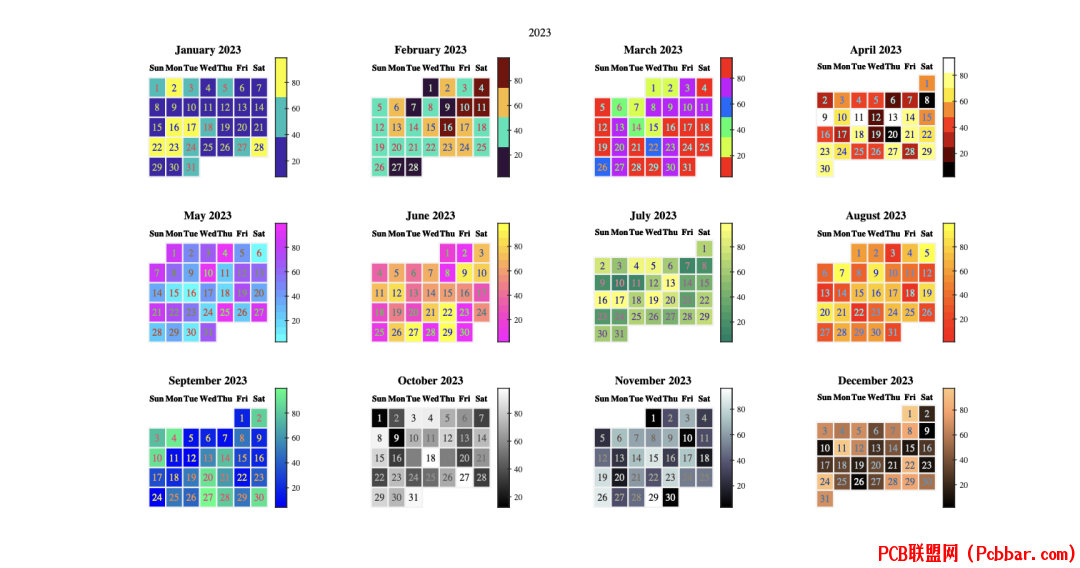

    全年每月设置不同的颜色条类型
  • clc; close all; clear;figure('Position',[1 72 1512 794])year=2023;cMapNum=[3,4,6,8,16,16,16,16,255,255,255,255];colormapList={parula,turbo,hsv,hot,cool,spring,summer,autumn,winter,gray,bone,copper,pink,jet};for month = 1:12    subplot(3,4,month)    data=rand(eomday(year,month),1)*100;    P=HeatmapCalendar('Data',data,'Year',year,'Month',month);    P.Colormap=colormapList{month};    P.CMapNum=cMapNum(month);    P.plot();    clear dataendsgtitle(num2str(year),'fontName','Times New Roman','FontSize',16)
