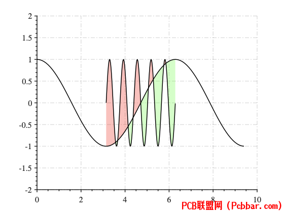

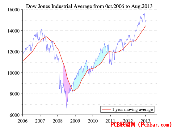

效果图
交叉折线图之间分色填充概念介绍交叉折线图之间的分色填充是一种高级数据可视化技巧,它涉及在两条或多条在一定区间内交叉或重叠的折线图之间应用不同的颜色填充。此技术主要用于图形化地表示两组或多组数据之间的比较和对比,特别是它们随时间或其他变量的变化。应用领域金融市场分析:展现不同金融工具或指数在时间序列中的表现,突出市场波动或趋势。

绘图工具函数fillArea收藏、点赞=学会
  • function fillArea(x1, y1, x2, y2, fillColor1, fillColor2, alphaValue)%--------------------------------------------------------------------------% @Author: 好玩的Matlab && 猪猪% @公众号:好玩的Matlab% @Created: 09,18,2023% @Email: 2377389590@qq.com% 尊重劳动成果,转载请备注推文链接和公众号名,严禁商用。%--------------------------------------------------------------------------plot(x1,y1,'color','none','HandleVisibility','off');plot(x2,y2,'color','none','HandleVisibility','off');% 调用函数x1 = x1(:); y1 = y1(:);x2 = x2(:); y2 = y2(:);% 查找交点[xi, yi] = polyxpoly(x1, y1, x2, y2);% 裁剪到共同的 x 轴范围xRange = [max(min(x1), min(x2)), min(max(x1), max(x2))];yRange = [min(min(y1), min(y2)), max(max(y1), max(y2))];%边界交叉点[xa1,ya1]=polyxpoly(x1, y1,[xRange(1),xRange(1)],yRange);[xb1,yb1]=polyxpoly(x1, y1,[xRange(2),xRange(2)],yRange);[xa2,ya2]=polyxpoly(x2, y2,[xRange(1),xRange(1)],yRange);[xb2,yb2]=polyxpoly(x2, y2,[xRange(2),xRange(2)],yRange);% 交叉点[x1,y1]=insertData(x1, y1, xi, yi);[x2,y2]=insertData(x2, y2, xi, yi);% 边界点插入[x1, y1] = insertData(x1, y1, xa1, ya1);[x1, y1] = insertData(x1, y1, xb1, yb1);[x2, y2] = insertData(x2, y2, xa2, ya2);[x2, y2] = insertData(x2, y2, xb2, yb2);% 提取范围数据xNew1 = x1(x1 >= xRange(1) & x1 2));yNew1 = y1(x1 >= xRange(1) & x1 2));xNew2 = x2(x2 >= xRange(1) & x2 2));yNew2 = y2(x2 >= xRange(1) & x2 2));[X1, Y1, X2, Y2] = equaLen(xNew1, yNew1, xNew2, yNew2);disp(char([20844 20247 21495 58 22909 29609 30340 77 97 116 108 97 98]))hold onfor i = 1:length(X1) - 1    % 确定填充颜色    if Y1(i) > Y2(i) || (Y1(i) == Y2(i) && Y1(i+1) > Y2(i+1))        color = fillColor1;    else        color = fillColor2;    end    % 填充    fill([X1(i) X1(i+1) X1(i+1) X1(i)], [Y1(i) Y1(i+1) Y2(i+1) Y2(i)], ...        color, 'EdgeColor', 'none', 'FaceAlpha', alphaValue, 'HandleVisibility', 'off');end    function [x1, y1, x2, y2] = equaLen(x1, y1, x2, y2)        % 确保两个多边形具有相同数量的点        % 同时保留原有的数据点        % 确定 x 的范围和新的 x 网格        xMin = min(min(x1), min(x2));        xMax = max(max(x1), max(x2));        % 生成一个包含所有原始 x 值的合并且排序的数组        xAll = unique([x1; x2]);        % 如果合并后的 xAll 长度小于两个数据集中最长的长度        % 则在 xAll 中插入额外的点以匹配最长的数据集长度        maxLength = max(length(x1), length(x2));        if length(xAll)             additionalPoints = linspace(xMin, xMax, maxLength - length(xAll) + 2);            xAll = unique([xAll; additionalPoints(:)]);        end        % 插值        y1 = interp1(x1, y1, xAll, 'linear', 'extrap');        y2 = interp1(x2, y2, xAll, 'linear', 'extrap');        % 更新 x1 和 x2        x1 = xAll;        x2 = xAll;    end    function [xUpdated, yUpdated] = insertData(xMain, yMain, xInsert, yInsert)        % 将 xInsert 和 yInsert 中的数据插入到 xMain 和 yMain 中        % 并确保结果是唯一的并且按照 x 的值排序        % 组合 xMain 和 xInsert        xCombined = [xMain; xInsert];        % 组合 yMain 和 yInsert        yCombined = [yMain; yInsert];        % 获取唯一的 x 值及其索引,并保持排序        [xUnique, idxUnique] = unique(xCombined, 'sorted');        % 使用这些索引过滤 yCombined        yUnique = yCombined(idxUnique);        % 返回更新后的 x 和 y        xUpdated = xUnique;        yUpdated = yUnique;    endend
    函数输入参数:
  • x1, y1, x2, y2: 这些参数分别代表两条曲线的 x 和 y 坐标值。
  • fillColor1, fillColor2: 用于填充的两种颜色。
  • alphaValue: 填充颜色的透明度。使用方法案例 1
  • clc;clear;close all;x1=pi:0.02:2*pi;x2=0:0.1:3*pi;y1=sin(10*x1);y2=cos(x2);% 定义填充颜色fillColor1 = 'r'; fillColor2 = 'g'; alphaValue=0.3;fillArea(x1, y1, x2, y2, fillColor1, fillColor2, alphaValue);plot(x1,y1,'-k','LineWidth',1.5);plot(x2,y2,'-k','LineWidth',1.5);ax=gca;ax.LineWidth=1.5;ax.FontName='Times new Roman';ax.FontSize=16;ax.Box='off';ax.XMinorTick='on';ax.YMinorTick='on';ax.TickDir='out';ax.GridLineStyle='-.';ax.YGrid='on';ax.XGrid='on';ax.YMinorGrid='off';ax.XMinorGrid='off';ax.MinorGridLineStyle=':';ax.YLim=[-2,2];

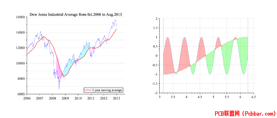

    案例 2

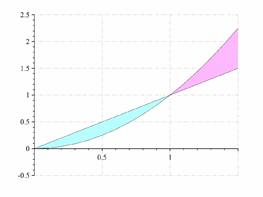

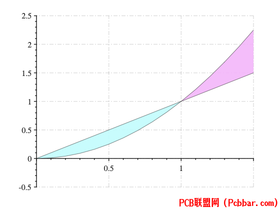

  • clc;clear;close all;x1=0:0.1:pi/2;x2=0:0.1:pi/2;y1=x1;y2=x2.^2;fillColor1 = [0.6953, 0.9961, 0.9961]; fillColor2 = [0.9961, 0.6992, 0.9961];alphaValue = 0.9;
    fillArea(x1,y1,x2,y2,fillColor1,fillColor2,alphaValue)plot(x1,y1,'-k');plot(x2,y2,'-k');
    ax=gca;ax.LineWidth=1.5;ax.XAxisLocation = 'origin';ax.YAxisLocation = 'origin';ax.FontName='Times new Roman';ax.FontSize=16;ax.Box='off';ax.XMinorTick='on';ax.YMinorTick='on';ax.TickDir='out';ax.GridLineStyle='-.';ax.YGrid='on';ax.XGrid='on';ax.YMinorGrid='off';ax.XMinorGrid='off';ax.MinorGridLineStyle=':';ax.YLim=[-0.5,2.5];
    案例 3

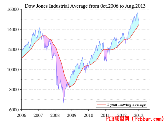

  • clc; clear; close all;% 读取数据:T = readtable("Book7.xls", 'VariableNamingRule', 'preserve'); % 基准数据data = table2array(T(:,2:3));x = (1:length(data))';  % 确保x是列向量x1=x;x2=x;y1 = data(:,1);y2 = data(:,2);
    % 绘制基本曲线和填充区域% 定义填充颜色fillColor1 = [0.6953, 0.9961, 0.9961]; % 浅蓝色fillColor2 = [0.9961, 0.6992, 0.9961]; % 浅紫色% 定义透明度alphaValue = 0.9;% 调用函数figurefillArea(x1, y1, x2, y2, fillColor1, fillColor2, alphaValue);plot(x1, y1, 'b','HandleVisibility','off');plot(x2, y2, 'r','LineWidth',1.5);defaultAxis(x)
    figurefillArea(x1(120:260), y1(120:260), x2, y2, fillColor1, fillColor2, alphaValue);plot(x1, y1, 'b','HandleVisibility','off');plot(x2, y2, 'r','LineWidth',1.5);defaultAxis(x)function defaultAxis(x)ax=gca;ax.LineWidth=1.5;ax.FontName='Times new Roman';ax.FontSize=16;ax.Box='off';ax.XMinorTick='off';ax.YMinorTick='on';ax.TickDir='out';ax.YGrid='on';ax.GridLineStyle='-.';ax.YMinorGrid='on';ax.MinorGridLineStyle=':';
    ax.XTick=linspace(0,length(x),8);ax.XTickLabel=arrayfun(@num2str, 2006:1:2013, 'UniformOutput', false);ax.YTick=6000:2000:16000;ax.YTickLabel=arrayfun(@num2str, 6000:2000:16000, 'UniformOutput', false);
    mainTicks = ax.YTick;minorTicks = mainTicks(1:end-1) + diff(mainTicks) / 2;ax.YAxis.MinorTickValues = minorTicks;ax.Title.String='Dow Jones Industrial Average from 0ct.2006 to Aug.2013';legend('1 year moving average','Location','southeast')end
