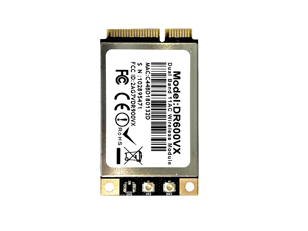

Qualcomm-Atheros-QCA9880-2T2R-MIMO-802.11ac-Mini-PCIe-Wi-Fi-Module-Dual-Band-2.4GHz-5GHz
Qualcomm-Atheros QCA9880 chipset
2.4GHz max 24dBm & 5GHz max 23dBm output power
IEEE 802.11accompliant & backward compatible with 802.11a/b/g/n
2x2 MIMO Technology, up to 867Mbps
Mini PCI Express edge connector
Support the Frequency 4920MHz~4980MHz
RoHS compliance ensure a high level protection of human health and the environment from risks that can be posed by chemicals
Supports Spatial Multiplexing, Cyclic-Delay Diversity (CDD), Low-Density Parity Check
(LDPC) Codes, Maximal Ratio Combining (MRC), Space Time Block Code (STBC)
Supports IEEE 802.11d, e, h, i, k, r, v time stamp, and w standards
Supports Dynamic Frequency Selection (DFS)

    Specifications
    Symbol
    Parameter
    Chipset
    QCA9880
    Host Interface
    Mini PCI Express 1.1 Standard
    Antenna Connector
    2 x UF.L
    Frequency Range
    2.4GHz: 2.412GHz to 2.472GHz
    5GHz: 4.920GHz to 5.825GHz
    Operating Voltage
    3.3V DC
    Power Consumption
    5W(Max)
    Modulation Techniques
    OFDM: BPSK, QPSK, DBPSK, DQPSK, 16-QAM, 64-QAM, 256-QAM
    Environmental Temperature
    Operating: -40°C to 70°C, Storage: -40°C to 90°C
    Environmental Humidity, non-condensing
    Operating: 5% to 95%, Storage: Max. 90%
    ROHS Compliance
    YES
    Dimensions (W×H×D)
    30.0mm × 50.9mm × 3.2mm
