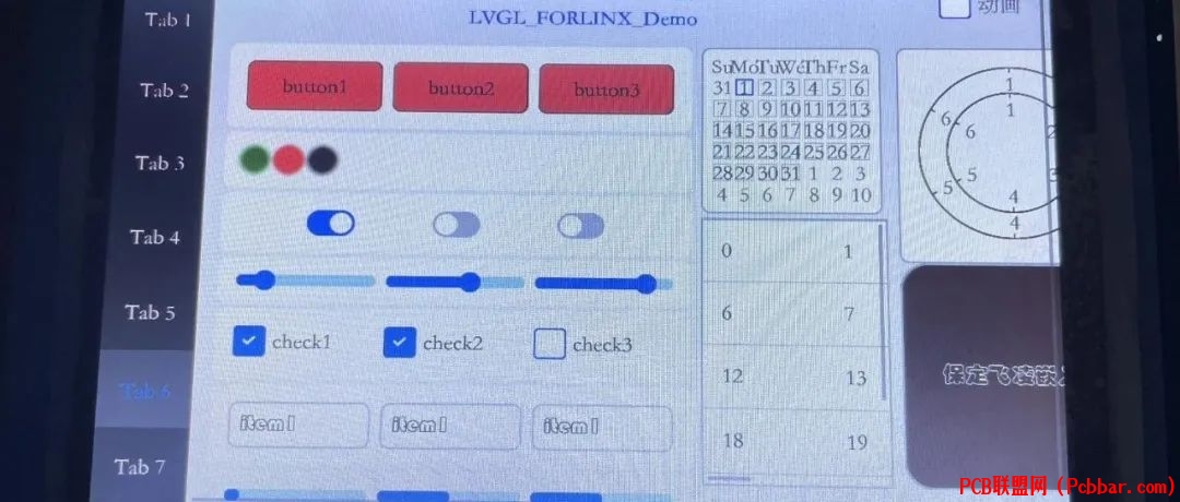

  • typedef struct {  void (*current_operate)(); //当前场景的处理函数  SCENE Index;               //当前场景的标签  SCENE Up;                  //按下Up键跳转的场景  SCENE Down;                //按下Down键跳转的场景  SCENE Right;               //按下Left键跳转的场景  SCENE Left;                //按下Right键跳转的场景}STAGE_TAB;2、函数映射表
  • STAGE_TAB stage_tab[]={  #.    operate       Index    Up     Down    Left   Right     {Stage1_Handler,  stage1,  stage4,  stage7,  stage3, stage2},  {Stage2_Handler,  stage2,  stage5,  stage8,  stage1, stage3},  {Stage3_Handler,  stage3,  stage6,  stage9,  stage2, stage1},  {Stage4_Handler,  stage4,  stage7,  stage1,  stage6, stage5},  {Stage5_Handler,  stage5,  stage8,  stage2, stage4,  stage6},  {Stage6_Handler,  stage6,  stage9,  stage3, stage5,  stage4},  {Stage7_Handler,  stage7,  stage1,  stage4, stage9,  stage8},  {Stage8_Handler,  stage8,  stage2,  stage5, stage7,  stage9},  {Stage9_Handler,  stage9,  stage3,  stage6, stage8,  stage7},};3、定义两个变量保存当前场景和上一个场景
  • char current_stage=stage1;char prev_stage=current_stage;4、按下Up按键 跳转到指定场景current_stage的值根据映射表改变
  • current_stage =stage_tab[current_stage].Up;5、场景改变后 根据映射表执行相应的函数Handler
  • if(current_stage!=prev_stage){  stage_tab[current_stage].current_operate();  prev_stage=current_stage;}
