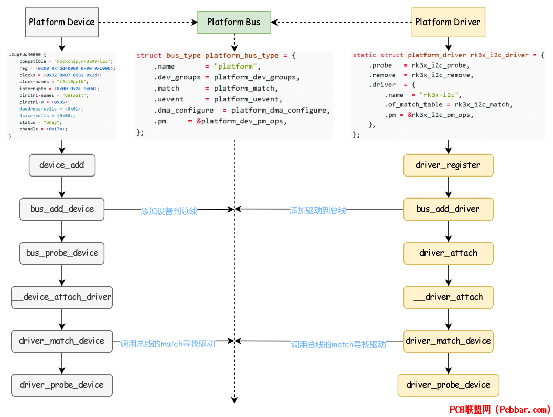

±¾ÆªÎÒÃÇÒÔ RK °åµÄ IIC ¿ØÖÆÆ÷ΪÀý£¬ÏȽ²½â Linux Ï嵀 IIC Çý¶¯¿ò¼Ü¡£
É豸Ê÷´´½¨ i2c É豸µÄ½Úµã£¬ÔÚÉ豸Ê÷±éÀúʱ»á´´½¨Ò»¸ö i2c µÄ platform É豸³öÀ´£º
  •      i2c@fdd40000 {         compatible = "rockchip,rk3399-i2c";         reg = 0x00 0xfdd40000 0x00 0x1000>;         clocks = 0x32 0x07 0x32 0x2d>;         clock-names = "i2c\0pclk";         interrupts = 0x00 0x2e 0x04>;         pinctrl-names = "default";         pinctrl-0 = 0x35>;         #address-cells = ;         #size-cells = ;         status = "okay";         phandle = 0x17a>;     }É豸°üº¬ÈçÏÂÐÅÏ¢£º
    compatible£º¼æÈÝÐÔ£¬ÓÃÓÚÆ¥Åä¿ÉÒÔÓÃÓÚ¸ÃÉ豸µÄÇý¶¯£»
    reg£º¸ÃÉ豸µÄ¼Ä´æÆ÷»ùµØÖ·ºÍ·¶Î§£»
    interrupts£ºi2c ÖжϿØÖÆÆ÷ʹÓõÄÖжÏÅäÖã»
    Õâ¸ö platform device ÔÚ±»·ÅÈëÆ½Ì¨×ÜÏßʱ£¬»áÆ¥Åä¶ÔÓ¦µÄ platform driver£¬ÄÇôÏÈÀ´¿´Ò»Ï platform bus ÊÇʲô£º
  • struct bus_type platform_bus_type = { .name= "platform", .dev_groups= platform_dev_groups, .match= platform_match, .uevent= platform_uevent, .dma_configure= platform_dma_configure, .pm= &platform_dev_pm_ops, };ÎÒÃÇÖ»¹Ø×¢ÆäÖÐµÄ match º¯Êý£¬ËüÊǵ±Ò»¸öеÄÉ豸»òÕßÒ»¸öеÄÇý¶¯±»Ìí¼Óµ½¸Ã×ÜÏßʱ»á±»µ÷ÓÃµÄÆ¥Å亯Êý£¬µ±Ò»¸öеÄÉ豸±»¼ÓÈëʱ£¬Ê¹Óà match À´Æ¥Åä¶ÔÓ¦µÄÇý¶¯£¬µ±Ò»¸öеÄÇý¶¯±»Ìí¼Óµ½¸Ã×ÜÏßʱ£¬Ò²»áʹÓÃÕâ¸ö match À´Æ¥ÅäÉ豸¡£
    ÎÒÃÇÒÔ rk °åµÄ i2c ƽ̨×ÜÏßÇý¶¯ÎªÀý£¬Ê×ÏÈÎÒÃÇÕÒµ½ rk °åµÄ i2c ƽ̨×ÜÏßÇý¶¯£º
  • static struct platform_driver rk3x_i2c_driver = { .probe   = rk3x_i2c_probe, .remove  = rk3x_i2c_remove, .driver  = { .name  = "rk3x-i2c", .of_match_table = rk3x_i2c_match, .pm = &rk3x_i2c_pm_ops, }, };ʹÓÃof_match_table À´Æ¥Åä¶ÔÓ¦µÄµÄÉ豸£¬Ê¹ÓÃprobe À´³õʼ»¯É豸¡£
    ÕûÌåÁ÷³ÌÈçÏ£º

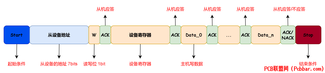

    IIC Ö÷»úÏò´Ó»úдÊý¾Ý£º

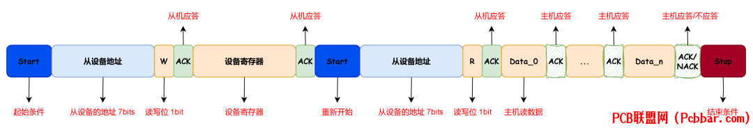

    IIC Ö÷»úÏò´Ó»ú¶ÁÊý¾Ý£º
    µ±È»IICµÄ·¢ËͽÓÊÕ²»Ö¹ÉÏÊöÁ½ÖÖģʽ£¬ÕâÀïÖ»ÌÖÂÛ³£ÓõÄÁ½ÖÖ·¢ËͺͽÓÊÕÊý¾ÝµÄ·½·¨¡£

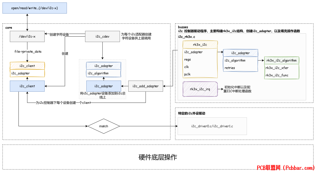

    È»ºóÎÒÃÇ¿ªÊ¼·ÖÎö IIC platform driver µÄ´úÂëÁË£º

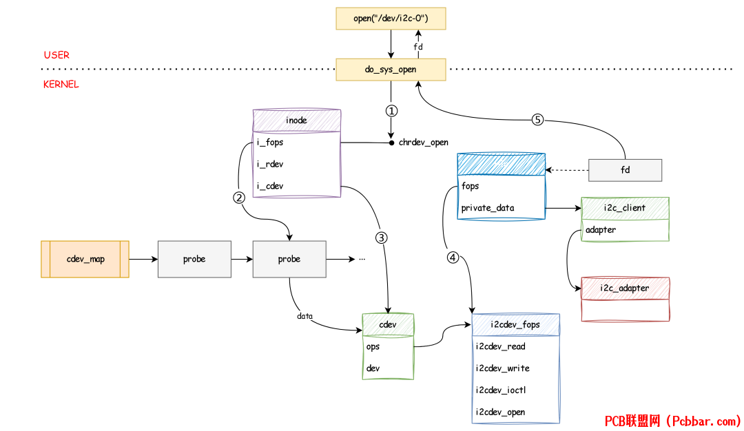

    ÎÒÃÇÒÔ RK board ΪÀý£¬Æä×ÜÏßÇý¶¯´úÂëÔÚ£ºdrivers\i2c\busses\i2c-rk3x.c ÖУ¬¾ßÌåʵÏÖ¿ÉÒԲο¼ÎÒ֮ǰµÄÎÄÕ£¬ÕâÀïÖ»¸ø³öÒ»¸öÕûÌå¿òͼ¡£×îÖÕ i2c µÄ¿ØÖÆÆ÷Ò²»áÒÔ×Ö·ûÉ豸½Úµã±©Â¶¸øÓû§Ì¬£¬ÎÒÃÇ¿ÉÒÔͨ¹ý i2c ¿ØÖÆÆ÷µÄ×Ö·ûÉ豸¸øÏàÓ¦µÄ i2c ÍâÉèͨÐÅ¡£
    È»ºó¿´Ò»ÏÂÓû§²ã´ò¿ªÒ»¸ö i2c ¿ØÖÆÆ÷¶ÔÓ¦µÄ×Ö·ûÉ豸½ÚµãµÄÕûÌåÁ÷³Ìͼ£º
    Õû¸öÁ÷³ÌÈçÏ£º
    µ±Ó¦ÓóÌÐò´ò¿ªÒ»¸öÉ豸Îļþʱ£¬Í¨¹ýϵͳµ÷Óà sys_open ½øÈëÄںˣ¬
    ÔÚÄں˿ռäÖÐÓÉ do_sys_open ¸ºÔð·¢ÆðÕû¸öÉ豸ÎļþµÄ´ò¿ª²Ù×÷£¬
    Ê×ÏÈ»ñµÃ¸ÃÉ豸ÎļþËù¶ÔÓ¦µÄ inode£¬È»ºóµ÷ÓÃÆäÖÐµÄ i_fop º¯Êý£¬¶Ô×Ö·ûÉ豸¶øÑÔ£¬i_fop º¯Êý¾ÍÊÇ chrdev_open£¬
    ºóÕßͨ¹ý inode ÖÐµÄ i_rdev ³ÉÔ±ÔÚ cdev_map ÖвéÕÒ¸ÃÉ豸Ëù¶ÔÓ¦µÄÉ豸¶ÔÏó cdev£¬
    Ôڳɹ¦ÕÒµ½Á˸ÃÉ豸¶ÔÏóºó£¬½« inode µÄ cdev ³ÉÔ±Ö¸Ïò¸Ã×Ö·ûÉ豸¶ÔÏó£¬ÕâÑùÏ´ÎÔÙ¶Ô¸ÃÉ豸Îļþ½Úµã½øÐдò¿ª²Ù×÷ʱ£¬¾Í¿ÉÒÔÖ±½Óͨ¹ý i_cdev ³ÉÔ±µÃµ½É豸½ÚµãËù¶ÔÓ¦µÄ×Ö·ûÉ豸¶ÔÏóÁË¡£
    ÄÚºËÔÚÿ´Î´ò¿ªÒ»¸öÉ豸Îļþʱ£¬»á²úÉúÒ»¸öÕûÐεÄÎļþÃèÊö·û fd ºÍÒ»¸öÐ嵀 struct file ¶ÔÏó filp À´¸ú×Ù¶Ô¸ÃÎļþµÄÕâÒ»´Î²Ù×÷£¬
    ÔÚ´ò¿ªÉ豸Îļþʱ£¬Äں˻Ὣ filp ºÍ fd ¹ØÁªÆðÀ´£¬Í¬Ê±»á½« cdev ÖÐµÄ ops ¸³Öµ¸ø filp->f_op£¬Í¬Ê±´´½¨ i2c_client£¬¹ØÁª i2c_adapter£¬²¢½« filp µÄ private_data ºÍ i2_client ¹ØÁªÆðÀ´¡£
    ×îºó sys_open ϵͳµ÷Óý«É豸ÎļþÃèÊö·û fd ·µ»Øµ½Óû§¿Õ¼ä¡£

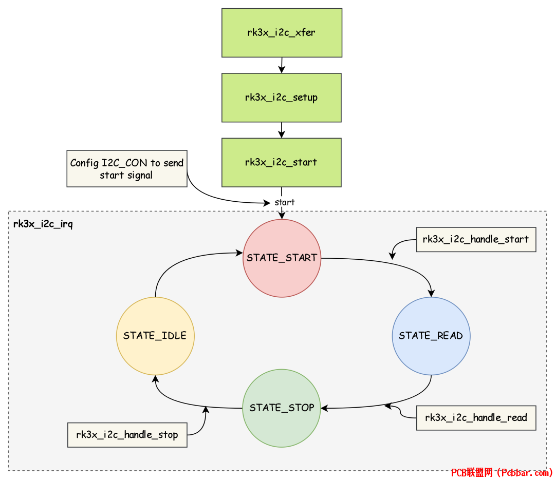

    È»ºóͨ¹ýrk3x_i2c_start ·¢ËÍ start ÐźſªÊ¼ i2c µÄÕû¸öÁ÷³Ì£¬²¢ÔÚrk3x_i2c_irq ÖÐά»¤Õû¸ö i2c Êý¾Ý·¢ËͺͽÓÊܵÄ״̬»ú£º
  • static irqreturn_t rk3x_i2c_irq(int irqno, void *dev_id) {     ... switch (i2c->state) { case STATE_START: rk3x_i2c_handle_start(i2c, ipd); break; case STATE_WRITE: rk3x_i2c_handle_write(i2c, ipd); break; case STATE_READ: rk3x_i2c_handle_read(i2c, ipd); break; case STATE_STOP: rk3x_i2c_handle_stop(i2c, ipd); break; case STATE_IDLE: break;   }     ... }ÔÚ Combined W/R ģʽϵÄÁ÷³ÌͼºÍ״̬»úÈçÏÂËùʾ£º
    Á÷³Ìͼ£º
    IIC Çý¶¯×´Ì¬»ú£º
