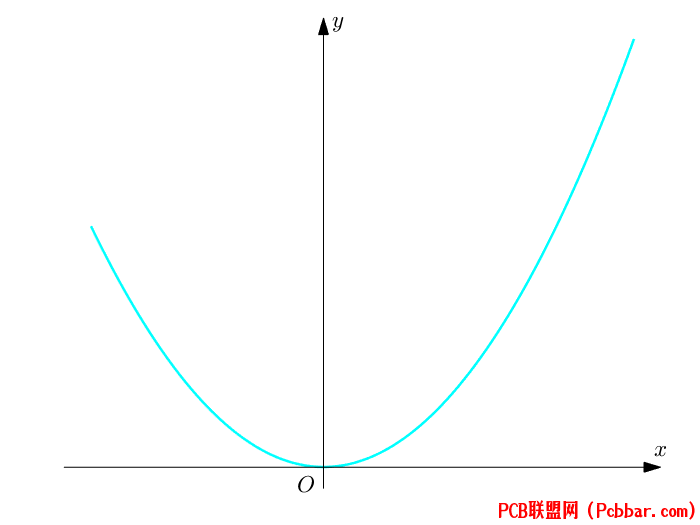

+ d, q: Q9 U- O5 w4 l3 ~; wdemo1
  • clear;figure('color', [1, 1, 1]);x = linspace(-3, 4, 100);y = x.^2;plot(x, y, 'Color', [0,1,1], 'LineWidth', 1.5);% 调用 DrawAxisWithArrow 即可在当前坐标轴绘制带箭头坐标轴param = struct('XLabel', '$x$', 'YLabel', '$y$', 'OLabel', '$O$');DrawAxisWithArrow(gca, param);%% 保存图像if true    img_name = SaveFig2Img(gcf, 'figures\demo01.png');    fprintf('图像保存为: %s3 v# i. f+ x0 w

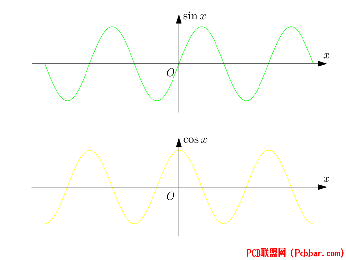

    9 l5 E  t/ L/ M; w+ ]+ k
  • clearback_color = [1, 1, 1];h_f = figure('Color', back_color);%% 绘制 sinsin_axis = subplot(211);x = linspace(-3*pi, 3*pi, 200);y = sin(x);plot(sin_axis, x, y, 'g-');xlim([-3*pi, 3*pi]);ylim([-1.2, 1.2]);% 绘制坐标轴param = struct('XLabel', '$x$', 'YLabel', '$\sin x$', 'OLabel', '$O$');DrawAxisWithArrow(sin_axis, param);%% 绘制 coscos_axis = subplot(212);y2 = cos(x);plot(cos_axis, x, y2, 'y-');xlim([-3*pi, 3*pi]);ylim([-1.2, 1.2]);param = struct('XLabel', '$x$', 'YLabel', '$\cos x$', 'OLabel', '$O$');DrawAxisWithArrow(cos_axis, param);
    ) U6 j3 L0 {9 l9 i7 [2 B0 g- G%% 保存为图像if true    img_name = SaveFig2Img(h_f, 'figures\demo02.png');    fprintf('图像保存为: %s
    2 C9 [% l" R& J2 w', img_name);end

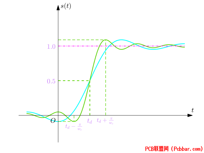

    %% 创建 axesh_a = axes('Parent', h_f);set(h_a, 'NextPlot', 'add'); % 相当于 hold on& G0 k1 N2 }/ N7 K
    %% 创建 plot% 绘制正弦积分函数fun = @(x)(sinc(x/pi));x = linspace(-1, 4, 400);y = zeros(1, length(x));4 m/ l" }( d- x7 _! |  d/ R
    wc = pi; % 截止频率td = 1;  % 时延for i = 1:length(x)    tmp = (x(i) - td)*wc;    y(i) = integral(fun, 0, tmp)/pi + 0.5;endplot(x, y, 'LineStyle', '-', 'Color', [0, 1, 1], 'LineWidth', 1.5);
    5 {0 b" P! \, O. D4 y3 vwc = 2*pi; % 增加截止频率td = 1;    % 时延for i = 1:length(x)    tmp = (x(i) - td)*wc;    y(i) = integral(fun, 0, tmp)/pi + 0.5;endplot(x, y, 'LineStyle', '-', 'Color', [0.39, 0.83, 0.07], 'LineWidth', 1.5);, M7 {) P2 p5 ?7 H. y: h* {
    % 其他标线lcolor = [0.39, 0.83, 0.07];plot([td, td], [0, 0.5], 'LineStyle', '--', 'Color', lcolor, 'LineWidth', 1.5)plot([0, td], [0.5, 0.5], 'LineStyle', '--', 'Color', lcolor, 'LineWidth', 1.5)plot([0, td+pi/wc], [1,1]*max(y), 'LineStyle', '--', 'Color', lcolor, 'LineWidth', 1)plot([1,1]*(td+pi/wc), [0, max(y)], 'LineStyle', '--', 'Color', lcolor, 'LineWidth', 1)plot([0, td-pi/wc], [1,1]*min(y), 'LineStyle', '--', 'Color', lcolor, 'LineWidth', 1)plot([1,1]*(td-pi/wc), [0, min(y)], 'LineStyle', '--', 'Color', lcolor, 'LineWidth', 1)plot([0,4], [1,1], 'LineStyle', '-.', 'Color', [1, 0, 1], 'LineWidth', 1);; v$ e/ A, E" |  P1 X
    % 设置坐标轴的范围xlim([-1, 4]);ylim([-0.3, 1.5]);
    , N0 f, u* Z$ t- m0 Z+ r5 t%% 绘制 arrowparam = struct('XLabel', '$t$', 'YLabel', '$s(t)$', 'OLabel', '$O$');DrawAxisWithArrow(h_a, param);%% 添加一些标注% 在axes上的(0,1)左侧添加标注fp = CoorFromAxis2Fig(h_a, [0,1]); % 将axes的坐标转化为figure上的坐标,下同param = struct('Color', [0.8, 0.52, 0.98], 'FontSize', 14);FigPointLabel(fp, '1.0', 'west', param);% 在axes上的(0,0.5)左侧添加标注fp = CoorFromAxis2Fig(h_a, [0,0.5]);param = struct('Color', [0.8, 0.52, 0.98], 'FontSize', 14);FigPointLabel(fp, '0.5', 'west', param);% 在axes上的(td,0)下方添加标注fp = CoorFromAxis2Fig(h_a, [td,0]);param = struct('Color', [0.8, 0.52, 0.98], 'FontSize', 14);FigPointLabel(fp, '$t_d$', 'south', param);% 在axes上的(td+pi/wc,0)下方添加标注fp = CoorFromAxis2Fig(h_a, [td+pi/wc,0]);param = struct('Color', [0.8, 0.52, 0.98], 'FontSize', 12);FigPointLabel(fp, '$t_d+\frac{\pi}{w_c}$', 'south', param);% 在axes上的(td-pi/wc,0)下方添加标注fp = CoorFromAxis2Fig(h_a, [td-pi/wc, min(y)]);param = struct('Color', [0.8, 0.52, 0.98], 'FontSize', 12);FigPointLabel(fp, '$t_d-\frac{\pi}{w_c}$', 'south', param);%% 保存图像if true    img_name = SaveFig2Img(h_f, 'figures\demo03.png');    fprintf('图像保存为: %s3 W. b9 {! j$ |4 M2 w( u2 c
    ', img_name);end
