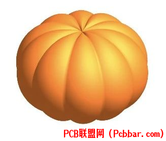

3 {1 y1 j( r- \- Y6 S" e9 a( W$ R% h代码绘制南瓜
  • clc;clear;close all;[X,Y,Z]=sphere(200);R=1+(-(1-mod(0:.1:20,2)).^2)/15;surf(R.*X,R.*Y,(.8+(0-(1:-.01:-1)'.^4)*.2).*Z.*R,'FaceC',[ 1 0.4588 0.0941],'EdgeC','n')axis('equal','off')material([ .6, .9, .3, 2, .5 ])lighting gcamlight

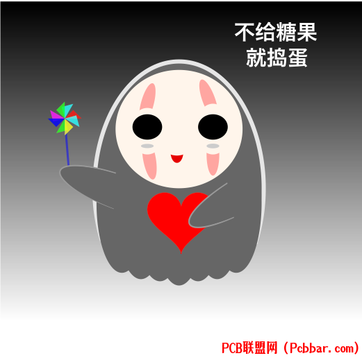

      o5 k, u; X% R7 x绘制无脸男小鬼: U& v% `2 C4 r6 P: F9 D
  • clc;clear;close allfig=figure('Position',[476 224 672 642]);ax=gca;ax.Color='none';ax.YLim=[0,15];ax.XLim=[-3,14];ax.Box='off';ax.XColor='none';ax.YColor='none';axis equal;hold onpause(0.1)[X, Y] = meshgrid(linspace(1, 0, 200));image([-3, 14], [0, 15], Y*255);colormap(gray)pause(0.1)ellipse = EllipsePlotter('a', 4, 'b', 6, 'x', 5.4, 'y', 6.2, ...    'plotType', 'fill', 'fillColor', [.4,.4,.4], 'rotation', 0, ...    'angleRange',[-25,205],'alpha',1,'lineWidth',6,'lineColor',[1,1,1]*0.9);ellipse.plotEllipse();d=[0 -0.3 -0.4 -0.6 -0.4 -0.3 0];for i=1:7    ellipse = EllipsePlotter('a',1.2, 'b', 3.3, 'x', 2.7+(i-1)*0.9, 'y', 5.5+d(i), ...        'plotType', 'fill', 'fillColor',[.4,.4,.4], 'rotation', 0, ...        'angleRange',[-200,20],'alpha',1,'lineWidth',6,'lineColor','none');    ellipse.plotEllipse();end% 脸pause(0.3)FaceColor=[1.0 0.9627 0.9235];ellipse = EllipsePlotter('a',3, 'b', 2.8, 'x',5.4, 'y',9, ...    'plotType', 'fill', 'fillColor',FaceColor, 'rotation', 0, ...    'angleRange',[0,360],'alpha',1,'lineWidth',2,'lineColor','none');ellipse.plotEllipse();% 眉毛、腮红、嘴pause(0.3)ellipse = EllipsePlotter('a',0.3, 'b',1, 'x',3.9, 'y',10.2, ...    'plotType', 'fill', 'fillColor',[1.0 0.65 0.63], 'rotation', 15, ...    'angleRange',[0,360],'alpha',1,'lineWidth',2,'lineColor','none');ellipse.plotEllipse();

    其中绘制风车代码:
  • hold onplot([0 0.2],[9.5 7],'LineWidth',3,'Color',[0,0,1,0.5]) colors = {'r', 'g', 'b', 'y';'c', 'm', 'g','c'};L = 0.8;center = [0,9.5]; % 定义风车的圆心T=[0 pi/3];for j = 1:4    for i=1:2        theta1 = (j-1) * pi/2+T(i);        theta2 = theta1 + pi/2;        P0 = center;        P1 = center + L * [cos(theta1), sin(theta1)];        P2 = center + L * [cos(theta2), sin(theta2)];        Psharp = (P1 + P2) / 2;        fill([P0(1), P1(1), Psharp(1)], [P0(2), P1(2), Psharp(2)], colors{i,j},'EdgeColor','none','FaceAlpha',0.8);    endend

    其中爱心代码:
    5 V, }' r1 X- M# Y
  • t=0:0.025:2*pi;x=(16*sin(t).^3)/10+5.5;y=(13*cos(t)-5*cos(2*t)-2*cos(3*t)-cos(4*t))/10+4.8;fill(x,y,'r','edgecolor','r');
