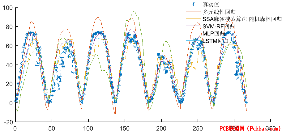

1.真实值和预测值展示图, Q# P, J# y0 V
% w& S9 Z9 ^6 L6 J1 h; c8 z; H1 @
, T& a, Z1 v8 z" G+ dTips:数据比较多、算法多的适合比较难看出实际的效果
4 B; x) l# }% B+ l  ~8 o" a; Q数据就是各个算法预测值和真实值数据(工具箱直接导出)# ^' `1 t: C' s% z3 `
  • data_pre_all=[]; %记录预测数据load(' 多元线性回归  17_Dec_11_34_33 train_result_train_vaild_test.mat')data1=data_Oriny_prey.y_test_predict;data_pre_all=[data_pre_all,data1];data_true=data_Oriny_prey.test_y;load('SSA麻雀搜索算法 随机森林回归  17_Dec_11_35_55 train_result_train_vaild_test.mat')data2=data_Oriny_prey.y_test_predict;data_pre_all=[data_pre_all,data2];load(' SVM-RF回归  17_Dec_11_37_18 train_result_train_vaild_test.mat')data3=data_Oriny_prey.y_test_predict;data_pre_all=[data_pre_all,data3];load(' MLP回归  17_Dec_11_38_31 train_result_train_vaild_test.mat')data4=data_Oriny_prey.y_test_predict;data_pre_all=[data_pre_all,data4];load(' LSTM回归  17_Dec_11_40_29 train_result_train_vaild_test.mat')data5=data_Oriny_prey.y_test_predict;data_pre_all=[data_pre_all,data5];str={'真实值','多元线性回归','SSA麻雀搜索算法 随机森林回归','SVM-RF回归' ,'MLP回归','LSTM回归'};figure('Units', 'pixels', ...    'Position', [300 300 860 375]);plot(data_true,'--*') hold onfor i=1:size(data_pre_all,2)    plot(data_pre_all(:,i))    hold on endlegend(str)set (gca,"FontSize",12,'LineWidth',1.2)box offlegend Box off

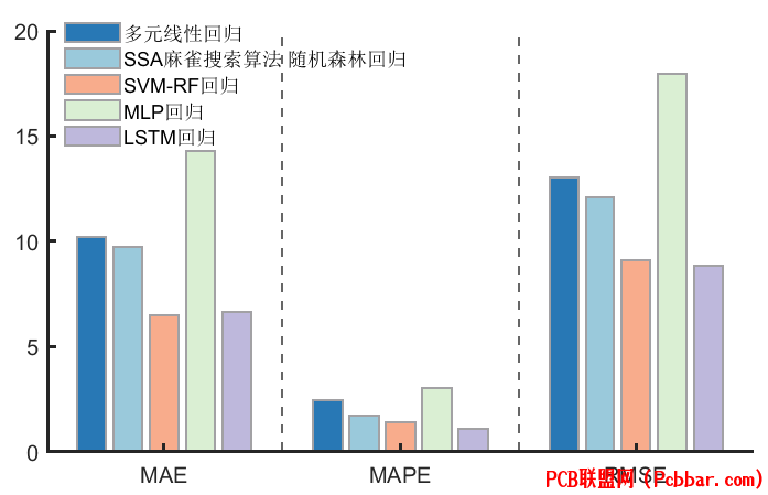

    2.误差柱状对比图
    9 D$ j+ V; a7 v, U% g4 L
    + i7 J' R+ ?7 ~; B2 M
    Tips:建议选取量纲差别不大的误差衡量指标,不然可能会有点丑
    / V& }, k5 V* t! p$ V; }
  • Test_all=[];for j=1:size(data_pre_all,2)    y_test_predict=data_pre_all(:,j);    test_y=data_true;    test_MAE=sum(abs(y_test_predict-test_y))/length(test_y) ;           test_MAPE=sum(abs((y_test_predict-test_y)./test_y))/length(test_y);      test_MSE=(sum(((y_test_predict-test_y)).^2)/length(test_y));     test_RMSE=sqrt(sum(((y_test_predict-test_y)).^2)/length(test_y));      test_R2= 1 - (norm(test_y - y_test_predict)^2 / norm(test_y - mean(test_y))^2);       Test_all=[Test_all;test_MAE test_MAPE test_MSE test_RMSE test_R2];end%%str={'真实值','多元线性回归','SSA麻雀搜索算法 随机森林回归','SVM-RF回归' ,'MLP回归','LSTM回归'};str1=str(2:end);str2={'MAE','MAPE','MSE','RMSE','R2'};data_out=array2table(Test_all);data_out.Properties.VariableNames=str2;data_out.Properties.RowNames=str1;disp(data_out)%% 柱状图 MAE MAPE RMSE 柱状图适合量纲差别不大的color=    [0.1569    0.4706    0.7098    0.6039    0.7882    0.8588    0.9725    0.6745    0.5490    0.8549    0.9373    0.8275       0.7451    0.7216    0.8627    0.7843    0.1412    0.1373    1.0000    0.5333    0.5176      0.5569    0.8118    0.7882       1.0000    0.5333    0.5176];figure('Units', 'pixels', ...    'Position', [300 300 660 375]);plot_data_t=Test_all(:,[1,2,4])';b=bar(plot_data_t,0.8);hold on- C% ?+ B/ Y/ s
    for i = 1 : size(plot_data_t,2)    x_data(:, i) = b(i).XEndPoints'; end8 l, l( i& Y' M$ x. O" W! j
    for i =1:size(plot_data_t,2)b(i).FaceColor = color(i,:);b(i).EdgeColor=[0.6353    0.6314    0.6431];b(i).LineWidth=1.2;end2 E7 z) v4 _0 s4 t* w) B5 k3 q, u* J& ^
    for i = 1 : size(plot_data_t,1)-1    xilnk=(x_data(i, end)+ x_data(i+1, 1))/2;    b1=xline(xilnk,'--','LineWidth',1.2);    hold onend 4 f9 M5 f6 t4 t: ~7 U* u
    ax=gca;legend(b,str1,'Location','best')ax.XTickLabels ={'MAE', 'MAPE', 'RMSE'};set(gca,"FontSize",12,"LineWidth",2)box offlegend box off

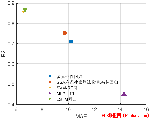

    " Z" P) y% a$ V/ ?; ]3.误差散点对比图5 A8 t! a0 `% N. B9 a, E! N8 E3 y0 D# v! Z
    5 N5 p6 n1 |5 C8 U4 MTips:可以任意选择两个误差衡量维度6 x- O9 J8 B3 g9 q7 |# k% q
  • figureplot_data_t1=Test_all(:,[1,5])';MarkerType={'s','o','pentagram','^','v'};for i = 1 : size(plot_data_t1,2)   scatter(plot_data_t1(1,i),plot_data_t1(2,i),120,MarkerType{i},"filled")   hold onendset(gca,"FontSize",12,"LineWidth",2)box offlegend box offlegend(str1,'Location','best')xlabel('MAE')ylabel('R2')grid on1 Q& M# C1 p7 W

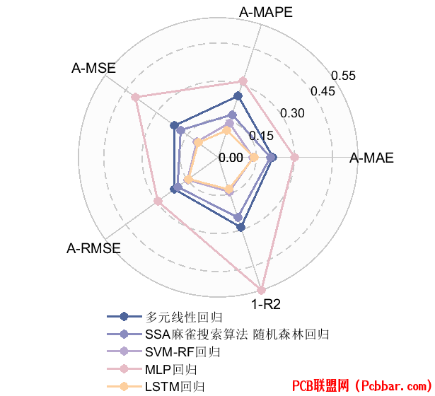

    # u0 A+ M* `9 b" n5 I/ [5 E5.误差雷达图
    8 u! g) k; q: e. ]
    4 @. B5 _( u6 [. bTips:为了让图片更美观将多个维度评价指标进行归一化处理了
      s  {4 Z1 T' ]* K% y$ @! ^
  • figure('Units', 'pixels', ...    'Position', [150 150 520 500]);Test_all1=Test_all./sum(Test_all);  %把各个指标归一化到一个量纲Test_all1(:,end)=1-Test_all(:,end);RC=radarChart(Test_all1);str3={'A-MAE','A-MAPE','A-MSE','A-RMSE','1-R2'};RC.PropName=str3;RC.ClassName=str1;RC=RC.draw(); RC.legend();colorList=[78 101 155;          138 140 191;          184 168 207;          231 188 198;          253 207 158;          239 164 132;          182 118 108]./255;for n=1:RC.ClassNum    RC.setPatchN(n,'Color',colorList(n,:),'MarkerFaceColor',colorList(n,:))end

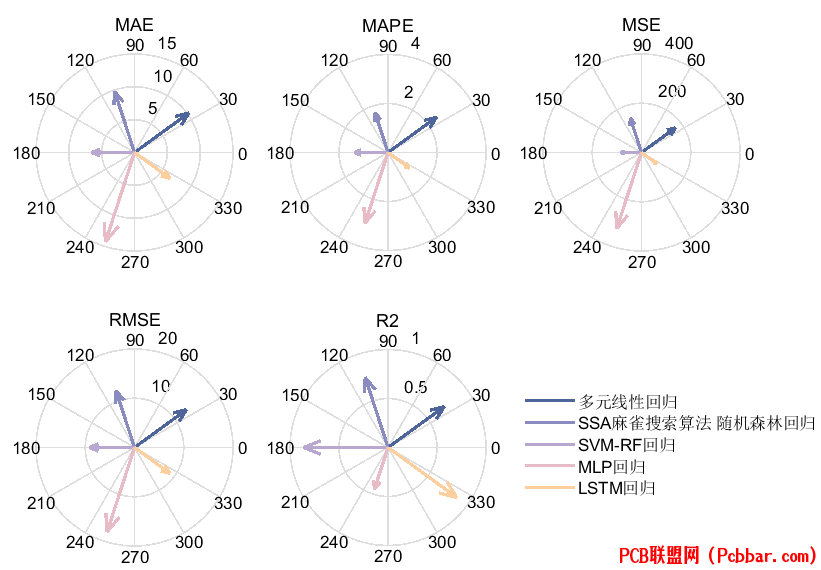

    6.误差罗盘图+ R' F  ^) W( r6 H. r( f0 W
    " _5 w# X! Z, K( y5 |- a7 B
  • figure('Units', 'pixels', ...    'Position', [150 150 920 600]);t = tiledlayout('flow','TileSpacing','compact');for i=1:length(Test_all(:,1))nexttileth1 = linspace(2*pi/length(Test_all(:,1))/2,2*pi-2*pi/length(Test_all(:,1))/2,length(Test_all(:,1)));r1 = Test_all(:,i)';[u1,v1] = pol2cart(th1,r1);M=compass(u1,v1);for j=1:length(Test_all(:,1))    M(j).LineWidth = 2;    M(j).Color = colorList(j,:);
    2 e$ ~" W+ a$ a& R' N* Rend   title(str2{i})set(gca,"FontSize",10,"LineWidth",1)end legend(M,str1,"FontSize",10,"LineWidth",1,'Box','off','Location','southoutside')' P5 e' j5 }2 |: @) B3 P
