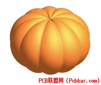

/ J  I% G8 f( b/ l代码绘制南瓜
  • clc;clear;close all;[X,Y,Z]=sphere(200);R=1+(-(1-mod(0:.1:20,2)).^2)/15;surf(R.*X,R.*Y,(.8+(0-(1:-.01:-1)'.^4)*.2).*Z.*R,'FaceC',[ 1 0.4588 0.0941],'EdgeC','n')axis('equal','off')material([ .6, .9, .3, 2, .5 ])lighting gcamlight7 G, C; Z6 }9 T1 x9 l1 u, N

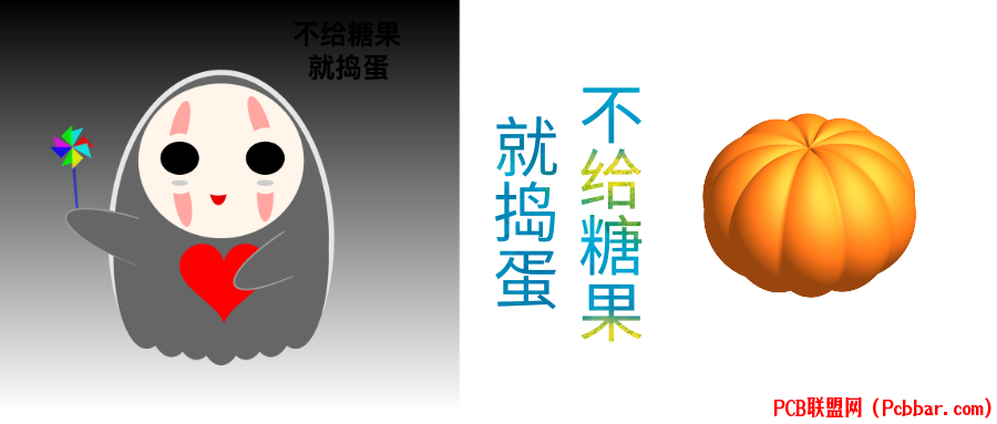

    ; }3 p4 w+ E5 y4 l# W绘制无脸男小鬼
    ( x# a4 y$ l8 U  m
  • clc;clear;close allfig=figure('Position',[476 224 672 642]);ax=gca;ax.Color='none';ax.YLim=[0,15];ax.XLim=[-3,14];ax.Box='off';ax.XColor='none';ax.YColor='none';axis equal;hold onpause(0.1)[X, Y] = meshgrid(linspace(1, 0, 200));image([-3, 14], [0, 15], Y*255);colormap(gray)pause(0.1)ellipse = EllipsePlotter('a', 4, 'b', 6, 'x', 5.4, 'y', 6.2, ...    'plotType', 'fill', 'fillColor', [.4,.4,.4], 'rotation', 0, ...    'angleRange',[-25,205],'alpha',1,'lineWidth',6,'lineColor',[1,1,1]*0.9);ellipse.plotEllipse();d=[0 -0.3 -0.4 -0.6 -0.4 -0.3 0];for i=1:7    ellipse = EllipsePlotter('a',1.2, 'b', 3.3, 'x', 2.7+(i-1)*0.9, 'y', 5.5+d(i), ...        'plotType', 'fill', 'fillColor',[.4,.4,.4], 'rotation', 0, ...        'angleRange',[-200,20],'alpha',1,'lineWidth',6,'lineColor','none');    ellipse.plotEllipse();end% 脸pause(0.3)FaceColor=[1.0 0.9627 0.9235];ellipse = EllipsePlotter('a',3, 'b', 2.8, 'x',5.4, 'y',9, ...    'plotType', 'fill', 'fillColor',FaceColor, 'rotation', 0, ...    'angleRange',[0,360],'alpha',1,'lineWidth',2,'lineColor','none');ellipse.plotEllipse();% 眉毛、腮红、嘴pause(0.3)ellipse = EllipsePlotter('a',0.3, 'b',1, 'x',3.9, 'y',10.2, ...    'plotType', 'fill', 'fillColor',[1.0 0.65 0.63], 'rotation', 15, ...    'angleRange',[0,360],'alpha',1,'lineWidth',2,'lineColor','none');ellipse.plotEllipse();% X, d! u) w& P8 \9 Y* z9 F
    ellipse = EllipsePlotter('a',0.3, 'b',1, 'x',6.8, 'y',10.4, ...    'plotType', 'fill', 'fillColor',[1.0 0.65 0.63], 'rotation', 160, ...    'angleRange',[0,360],'alpha',1,'lineWidth',2,'lineColor','none');ellipse.plotEllipse();ellipse = EllipsePlotter('a',0.3, 'b',1, 'x',7, 'y',7.8, ...    'plotType', 'fill', 'fillColor',[1.0 0.65 0.63], 'rotation', 0, ...    'angleRange',[-200,20],'alpha',1,'lineWidth',2,'lineColor','none');ellipse.plotEllipse();ellipse = EllipsePlotter('a',0.3, 'b',1, 'x',4, 'y',7.6, ...    'plotType', 'fill', 'fillColor',[1.0 0.65 0.63], 'rotation', -10, ...    'angleRange',[-200,20],'alpha',1,'lineWidth',2,'lineColor','none');ellipse.plotEllipse();pause(0.3)ellipse = EllipsePlotter('a',.84, 'b',1.1, 'x',3.9, 'y',8.9, ...    'plotType', 'fill', 'fillColor',FaceColor, 'rotation', 0, ...    'angleRange',[0,360],'alpha',1,'lineWidth',2,'lineColor','none');ellipse.plotEllipse();ellipse = EllipsePlotter('a',.84, 'b',1.2, 'x',7, 'y',9, ...    'plotType', 'fill', 'fillColor',FaceColor, 'rotation', 0, ...    'angleRange',[0,360],'alpha',1,'lineWidth',2,'lineColor','none');ellipse.plotEllipse();%嘴巴pause(0.3)ellipse = EllipsePlotter('a',.3, 'b',.5, 'x',5.3, 'y',7.9, ...    'plotType', 'fill', 'fillColor',[0.9 0 0], 'rotation', 0, ...    'angleRange',[-180,0],'alpha',1,'lineWidth',2,'lineColor','none');ellipse.plotEllipse();2 p' Z, N. a# J( A
    ellipse = EllipsePlotter('a',.5, 'b',.25, 'x',5.3, 'y',8, ...    'plotType', 'fill', 'fillColor',FaceColor, 'rotation', 0, ...    'angleRange',[-180,0],'alpha',1,'lineWidth',2,'lineColor','none');ellipse.plotEllipse();%眼袋pause(0.2)ellipse = EllipsePlotter('a',0.3, 'b',0.1, 'x',3.9, 'y',8.2, ...    'plotType', 'fill', 'fillColor',[1 1 1]*0.8, 'rotation', 0, ...    'angleRange',[0,360],'alpha',1,'lineWidth',2,'lineColor','none');ellipse.plotEllipse();ellipse = EllipsePlotter('a',0.3, 'b',0.11, 'x',7, 'y',8.2, ...    'plotType', 'fill', 'fillColor',[1 1 1]*0.8, 'rotation', 0, ...    'angleRange',[0,360],'alpha',1,'lineWidth',2,'lineColor','none');ellipse.plotEllipse();% 眼睛pause(0.3)ellipse = EllipsePlotter('a',0.7, 'b',0.6, 'x',3.9, 'y',9.1, ...    'plotType', 'fill', 'fillColor',[0 0 0], 'rotation', 0, ...    'angleRange',[0,360],'alpha',1,'lineWidth',2,'lineColor','none');ellipse.plotEllipse();ellipse = EllipsePlotter('a',0.7, 'b',0.6, 'x',7, 'y',9.1, ...    'plotType', 'fill', 'fillColor',[0 0 0], 'rotation', 0, ...    'angleRange',[0,360],'alpha',1,'lineWidth',2,'lineColor','none');ellipse.plotEllipse();% 心pause(0.3)t=0:0.025:2*pi;x=(16*sin(t).^3)/10+5.5;y=(13*cos(t)-5*cos(2*t)-2*cos(3*t)-cos(4*t))/10+4.8;fill(x,y,'r','edgecolor','r');%风车pause(0.3)plot([0 0.2],[9.5 7],'LineWidth',3,'Color',[0,0,1,0.5]) colors = {'r', 'g', 'b', 'y';'c', 'm', 'g','c'};L = 0.8;center = [0,9.5]; % 定义风车的圆心T=[0 pi/3];for j = 1:4    for i=1:2        theta1 = (j-1) * pi/2+T(i);        theta2 = theta1 + pi/2;        P0 = center;        P1 = center + L * [cos(theta1), sin(theta1)];        P2 = center + L * [cos(theta2), sin(theta2)];        Psharp = (P1 + P2) / 2;        fill([P0(1), P1(1), Psharp(1)], [P0(2), P1(2), Psharp(2)], colors{i,j},'EdgeColor','none','FaceAlpha',0.8);    endend%手pause(0.3)ellipse = EllipsePlotter('a',3, 'b',0.8, 'x',8.5, 'y',6, ...    'plotType', 'fill', 'fillColor',[.4 .4 .4], 'rotation', -30, ...    'angleRange',[100,250],'alpha',1,'lineWidth',2,'lineColor',[1,1,1]*0.6);ellipse.plotEllipse();ellipse = EllipsePlotter('a',3, 'b',0.8, 'x',8.7, 'y',6.1, ...    'plotType', 'fill', 'fillColor',[.4 .4 .4], 'rotation', -30, ...    'angleRange',[100,250],'alpha',1,'lineWidth',2,'lineColor','none');ellipse.plotEllipse();pause(0.3)ellipse = EllipsePlotter('a',3, 'b',0.8, 'x',2.6, 'y',6, ...    'plotType', 'fill', 'fillColor',[.4 .4 .4], 'rotation',20, ...    'angleRange',[100,270],'alpha',1,'lineWidth',2,'lineColor',[1,1,1]*0.6);ellipse.plotEllipse();ellipse = EllipsePlotter('a',3, 'b',0.8, 'x',2.7, 'y',5.95, ...    'plotType', 'fill', 'fillColor',[.4 .4 .4], 'rotation',20, ...    'angleRange',[100,270],'alpha',1,'lineWidth',2,'lineColor','none');ellipse.plotEllipse();pause(0.3)tex=sprintf('不给糖果$ F* e6 U) n- E5 E9 P" m2 S
      就捣蛋');text(8,13,tex,'FontSize',30,'FontWeight','bold','Color','w');# y' v! x: Z/ D( ]# K8 I2 n
    & W4 B5 Y* v  L
    其中绘制风车代码:
  • hold onplot([0 0.2],[9.5 7],'LineWidth',3,'Color',[0,0,1,0.5]) colors = {'r', 'g', 'b', 'y';'c', 'm', 'g','c'};L = 0.8;center = [0,9.5]; % 定义风车的圆心T=[0 pi/3];for j = 1:4    for i=1:2        theta1 = (j-1) * pi/2+T(i);        theta2 = theta1 + pi/2;        P0 = center;        P1 = center + L * [cos(theta1), sin(theta1)];        P2 = center + L * [cos(theta2), sin(theta2)];        Psharp = (P1 + P2) / 2;        fill([P0(1), P1(1), Psharp(1)], [P0(2), P1(2), Psharp(2)], colors{i,j},'EdgeColor','none','FaceAlpha',0.8);    endend
    ( Z  f0 t( T3 l) }* o: P- S
    2 i1 p+ @5 K$ c) C: c) r其中爱心代码:
    : x  [. z0 W% s8 M' p" L& n3 X
  • t=0:0.025:2*pi;x=(16*sin(t).^3)/10+5.5;y=(13*cos(t)-5*cos(2*t)-2*cos(3*t)-cos(4*t))/10+4.8;fill(x,y,'r','edgecolor','r');" h& O2 r) a$ H( X5 c$ J0 D2 ^7 S
    4 s, C% [- Q; x其中 EllipsePlotter类函数代码如下
      J1 {% d3 K! K3 J! o
  • classdef EllipsePlotter    properties        a = 1;        b = 1;        x = 0;        y = 0;        angleRange = [0 2*pi];        rotation = 0;        lineColor = 'b';        lineWidth = 1;        plotType = 'plot';        fillColor = 'r';        alpha = 1;    end    methods        function obj = EllipsePlotter(varargin)            % Constructor            if nargin > 0                for i = 1:2:nargin                    obj.(varargin{i}) = varargin{i+1};                end            end            startRadian = obj.angleRange(1) * pi / 180;            endRadian = obj.angleRange(2) * pi / 180;            theta = startRadian:pi/100:endRadian;        end        function plotEllipse(obj)            startRadian = obj.angleRange(1) * pi / 180;            endRadian = obj.angleRange(2) * pi / 180;            theta = startRadian:pi/100:endRadian;            X = obj.a * cos(theta);            Y = obj.b * sin(theta);            % 旋转坐标            rotationMatrix = [cosd(obj.rotation), -sind(obj.rotation); sind(obj.rotation), cosd(obj.rotation)];            xyRotated = [X; Y]' * rotationMatrix;            % 将旋转后的椭圆平移到指定的位置            XY(:,1) = xyRotated(:,1) + obj.x;            XY(:,2) = xyRotated(:,2) + obj.y;            % 根据 plotType 来绘制椭圆            if strcmp(obj.plotType, 'plot')                plot(XY(:,1), XY(:,2), '-', 'Color', obj.lineColor, 'LineWidth', obj.lineWidth);                hold on; axis equal            elseif strcmp(obj.plotType, 'fill')                fill(XY(:,1), XY(:,2), obj.fillColor, 'EdgeColor', obj.lineColor, 'FaceAlpha', obj.alpha, 'LineWidth', obj.lineWidth);                hold on; axis equal            else                error('无效的 plotType 参数!');            end        end    endend
