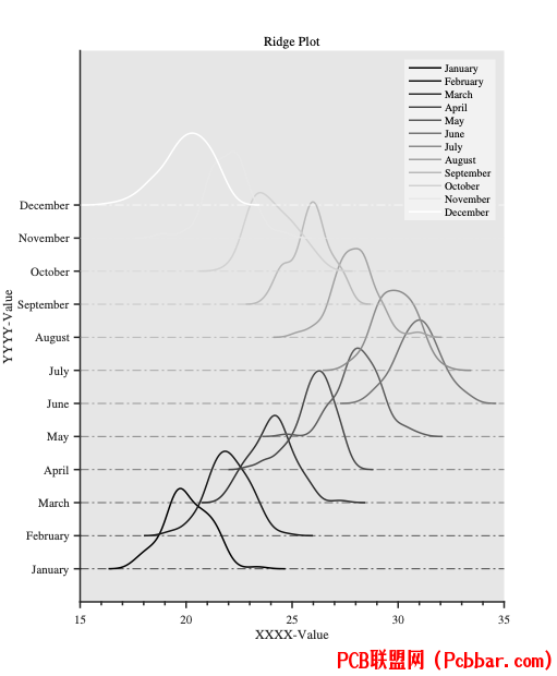

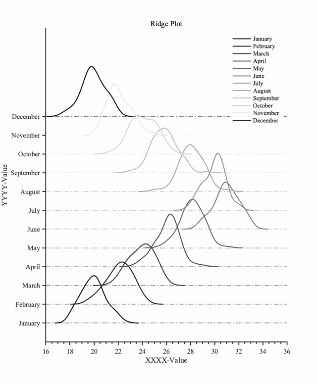

绘图教程线条山脊图
  • data = randn(100,12)+[ 20 22 24 26 28 31 30 28 26 24 22 20];lgLable= {'January', 'February', 'March', 'April', 'May', 'June','July', 'August', 'September', 'October', 'November', 'December'};colors=makeColorMap([0,0,0;1,1,1],12);figure('Position',[476 246 511 620])p=0.15;yTick=(1:size(data, 2))*p;for i = 1:size(data, 2)    [f, x] = ksdensity(data(:, i));    f=f+i*p;    pHandle=plot(x, f, 'LineWidth', 1.5,'color',colors(i,:));    hold on;    yline(yTick(i),'-.','LineWidth',1,'Color',pHandle.Color,'HandleVisibility','off')endgrid off;box off;legend(lgLable,'box','on','Color',[1,1,1]*0.95,'EdgeColor','none');set(gca, 'YTick',yTick , 'YTickLabel',lgLable,'LineWidth', 1.5, 'XMinorTick', 'on', 'TickDir', 'out', ...    'fontname','Times new Roman','color',[1,1,1]*0.9);xlabel('XXXX-Value');ylabel('YYYY-Value');title('Ridge Plot');hold off;. B% n" f( `# m" _# T

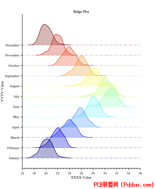

    填充山脊图
  • data = randn(100,12)+[ 20 22 24 26 28 31 30 28 26 24 22 20];lgLable= {'January', 'February', 'March', 'April', 'May', 'June','July', 'August', 'September', 'October', 'November', 'December'};% colors=makeColorMap(winter,size(data, 2));colors=makeColorMap(jet,size(data, 2));figure('Position',[476 246 511 620])p =0.2;hold on;for i = size(data, 2):-1:1    [f, x] = ksdensity(data(:, i));    fShifted = f + i * p;    pHandle = plot(x, fShifted,'color',colors(i,:),'LineWidth', 1.5,'HandleVisibility', 'off');    yline(i * p, '-.', 'LineWidth', 1, 'Color', colors(i,:),'HandleVisibility', 'off')    Xfill = [x, fliplr(x)];    Yfill = [fShifted, ones(1, length(x)) * i * p];    fill(Xfill, Yfill, pHandle.Color, 'EdgeColor', 'none', 'FaceAlpha', 0.3);endyTick = (1:size(data, 2)) * p;set(gca, 'YTick', yTick, ...    'YTickLabel', lgLable, ...    'LineWidth', 1.5, 'XMinorTick', 'on', 'TickDir', 'out', ...    'fontname','Times new Roman');xlabel('XXXX-Value');ylabel('YYYY-Value');title('Ridge Plot');ax = gca;hold off;?

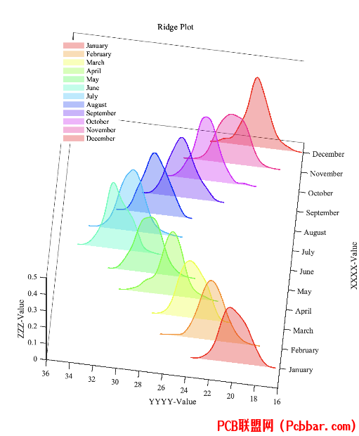

    3D填充山脊图
  • data = randn(100,12)+[ 20 22 24 26 28 31 30 28 26 24 22 20];lgLabel= {'January', 'February', 'March', 'April', 'May', 'June','July', 'August', 'September', 'October', 'November', 'December'};p = 0.2;xTick=(1:size(data, 2))*p;figure('Position',[476 246 511 620])hold on;colors=makeColorMap(hsv,size(data, 2));legendHandles = zeros(size(data, 2), 1);for i = 1:size(data, 2)    [f, y] = ksdensity(data(:, i));    xShifted = i * p;    plot3(xShifted * ones(size(f)), y, f, 'LineWidth', 1.5, 'Color', colors(i,:), 'HandleVisibility', 'off');    Yfill = [y, fliplr(y)];    Xfill = [xShifted * ones(1, length(y)), xShifted * ones(1, length(y))];    Zfill = [f, zeros(size(f))];    legendHandles(i)  = fill3(Xfill, Yfill, Zfill, colors(i,:), 'EdgeColor', 'none', 'FaceAlpha', 0.3); endgrid off;box on;legend(lgLabel,'box','on','Color',[1,1,1]*0.95,'EdgeColor','none','FontName','Times New Roman','location','best');set(gca, 'XTick',xTick, 'XTickLabel',lgLabel,'FontName','Times New Roman','linewidth',1)xlabel('XXXX-Value');ylabel('YYYY-Value');zlabel('ZZZ-Value');title('Ridge Plot');view([-83.4000   71.6830])hold off;

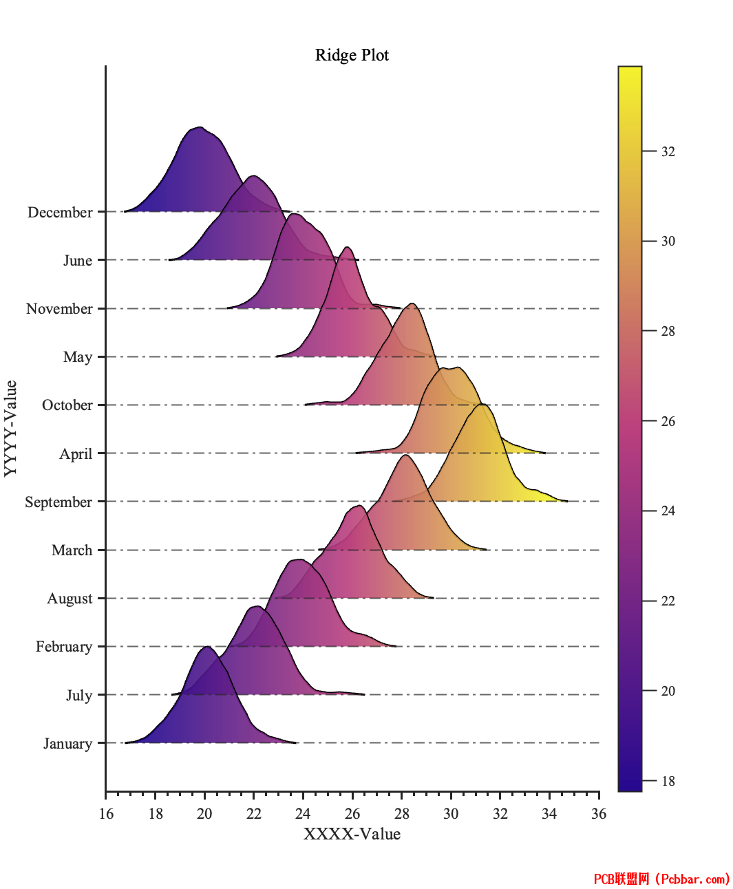

    / y2 R4 u3 O* T9 A* L' h横坐标方向、全局渐变的散点图' C1 ~$ ]" r& _9 S8 c/ |* E7 I
  • data = randn(100,12)+[ 20 22 24 26 28 31 30 28 26 24 22 20];lgLabel={'January', 'February', 'March', 'April', 'May', 'June',    'July', 'August', 'September', 'October', 'November', 'December'};p = 0.2;numColors = 256;% 创建一个从紫色到红色再到黄色的颜色映射colorMap =makeColorMap([0.1490    0.0353    0.5608;0.7305    0.2500    0.4922;0.9569    0.9490    0.1765],numColors);% 计算全局的x轴范围xMin = min(data, [], 'all');xMax = max(data, [], 'all');figure('Position',[476 246 511 620])hold on;for i = size(data, 2):-1:1    [f(i,:), x] = ksdensity(data(:, i), 'Kernel', 'triangle');    fShifted = f(i,:) + i * p; % 偏移每个分布    plot(x, fShifted, 'LineWidth', 1.5, 'color', 'k', 'HandleVisibility', 'off');    yline(i * p, '-.', 'LineWidth', 1, 'HandleVisibility', 'off');    for j = 1:length(x)-1        Xfill = [x(j), x(j+1), x(j+1), x(j)];        Yfill = [i * p, i * p, fShifted(j+1), fShifted(j)];        % 计算当前点的颜色比例        colorRatio = (x(j) - xMin) / (xMax - xMin);        colorIdx = min(numColors, max(1, round(colorRatio * (numColors - 1)) + 1));        fill(Xfill, Yfill, colorMap(colorIdx, :), 'EdgeColor', 'none', 'FaceAlpha', 0.9);    endend% 设置轴标签和标题yTick = (1:size(data, 2)) * p;set(gca, 'YTick', yTick, ...    'YTickLabel', lgLabel, ...    'LineWidth', 1.5, 'XMinorTick', 'on', 'TickDir', 'out', ...    'fontname','Times new Roman');xlabel('XXXX-Value');ylabel('YYYY-Value');title('Ridge Plot');% 设置颜色条colormap(colorMap);cBar = colorbar;cBar.TickDirection = 'out';cBar.LineWidth = 1;cBar.TickLength = 0.02;cBar.FontName = 'Times new Roman';caxis([xMin,xMax]);hold off;

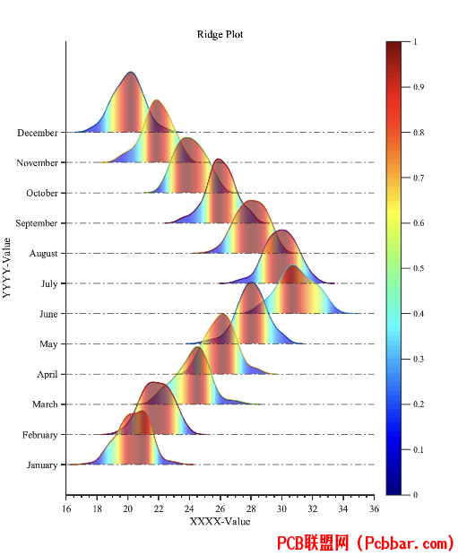

    横坐标方向、单核渐变图
  • data = randn(100,12) + [20 22 24 26 28 31 30 28 26 24 22 20];lgLabel = {'January', 'February', 'March', 'April', 'May', 'June', 'July', 'August', 'September', 'October', 'November', 'December'};numColors = 256; % 颜色数量colors = jet(numColors); % 使用jet颜色映射figure('Position',[476 246 511 620])p = 0.2;hold on;for i = size(data, 2):-1:1    [f, x] = ksdensity(data(:, i));    fShifted = f + i * p;    plot(x, fShifted, 'LineWidth', 1.5, 'HandleVisibility', 'off');    yline(i * p, '-.', 'LineWidth', 1, 'HandleVisibility', 'off');    colorGradient = linspace(1, numColors, length(x));    for j = 1:length(x)-1        Xfill = [x(j), x(j+1), x(j+1), x(j)];        Yfill = [i * p, i * p, fShifted(j+1), fShifted(j)];        fill(Xfill, Yfill, colors(round(colorGradient(j)), :), 'EdgeColor', 'none', 'FaceAlpha', 0.7);    endendyTick = (1:size(data, 2)) * p;set(gca, 'YTick', yTick, 'YTickLabel', lgLabel, ...    'LineWidth', 1.5, 'XMinorTick', 'on', 'TickDir', 'out', ...    'fontname', 'Times new Roman');xlabel('XXXX-Value');ylabel('YYYY-Value');title('Ridge Plot');colormap(colors);cBar = colorbar;cBar.TickDirection = 'out';cBar.LineWidth = 1;cBar.TickLength = 0.02;cBar.FontName = 'Times new Roman';hold off;

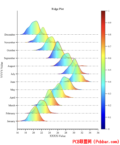

    山脊图的 Y值映射颜色变化% X3 z2 k8 {8 P9 T/ ~- ?, n
  • data = randn(100,12) + [20 22 24 26 28 31 30 28 26 24 22 20];lgLabel = {'January', 'February', 'March', 'April', 'May', 'June', 'July', 'August', 'September', 'October', 'November', 'December'};numColors = 100; % 颜色数量colors =makeColorMap(jet, numColors);figure('Position',[476 246 511 620])p = 0.2;hold on;for i = size(data, 2):-1:1    [f, x] = ksdensity(data(:, i));    fShifted = f + i * p;    plot(x, fShifted, 'LineWidth', 1.5, 'HandleVisibility', 'off');    yline(i * p, '-.', 'LineWidth', 1, 'HandleVisibility', 'off');    % 计算整个分布的最小和最大纵坐标    minY = min(fShifted);    maxY = max(fShifted);    for j = 1:length(x)-1        Xfill = [x(j), x(j+1), x(j+1), x(j)];        Yfill = [i * p, i * p, fShifted(j+1), fShifted(j)];        avgY = mean(Yfill(3:4));         colorIdx = round(((avgY - minY) / (maxY - minY)) * (numColors - 1)) + 1;        fill(Xfill, Yfill, colors(colorIdx, :), 'EdgeColor', 'none', 'FaceAlpha', 0.6);    endendyTick = (1:size(data, 2)) * p;set(gca, 'YTick', yTick, 'YTickLabel', lgLabel, ...    'LineWidth', 1.5, 'XMinorTick', 'on', 'TickDir', 'out', ...    'fontname', 'Times new Roman');xlabel('XXXX-Value');ylabel('YYYY-Value');title('Ridge Plot');colormap(colors);cBar = colorbar;cBar.TickDirection = 'out';cBar.LineWidth = 1;cBar.TickLength = 0.02;cBar.FontName = 'Times new Roman';hold off;7 x) w) U  \7 e: n; c4 ~
