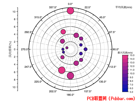

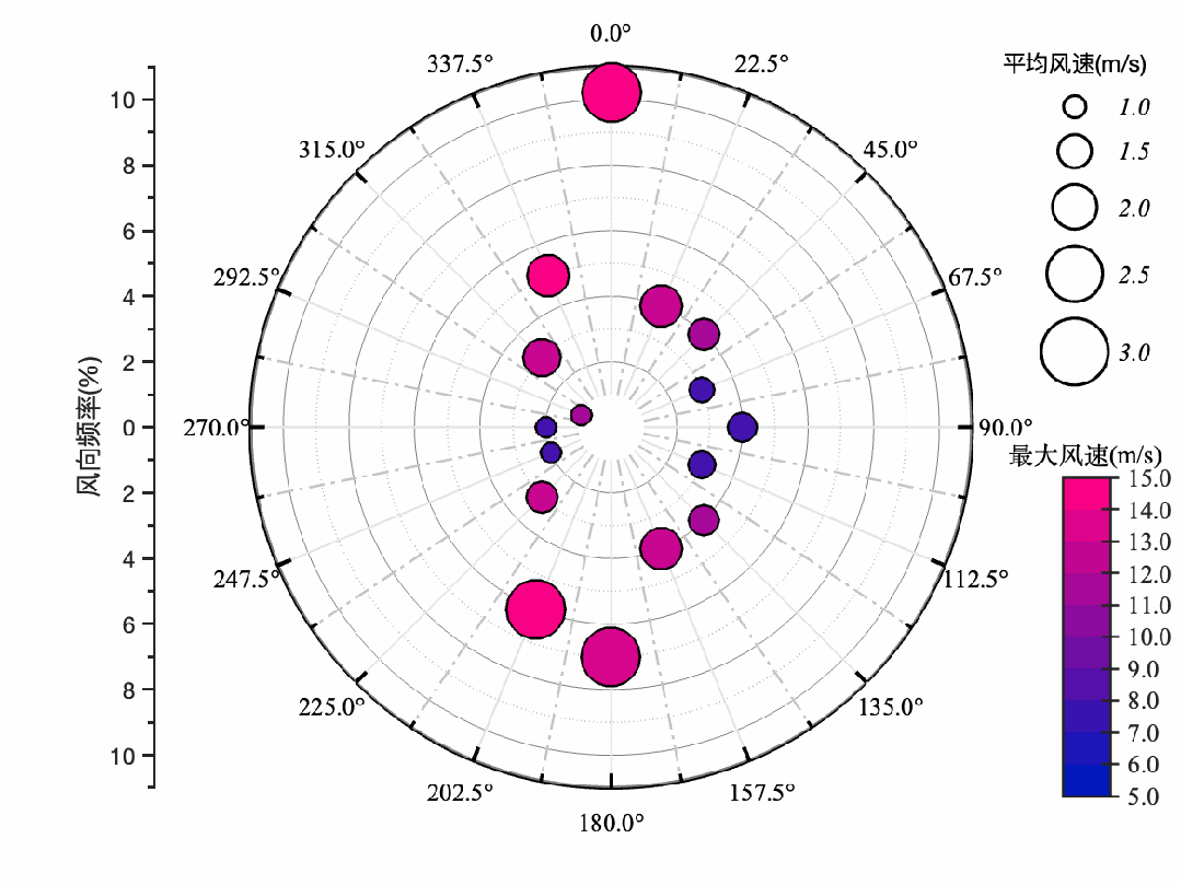

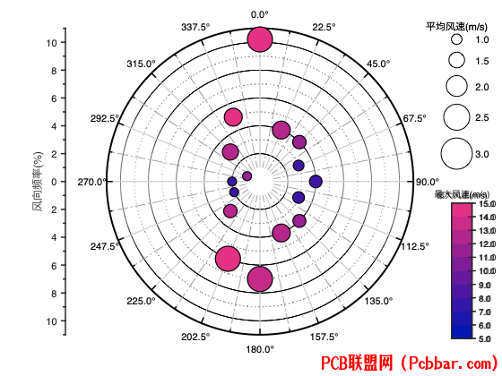

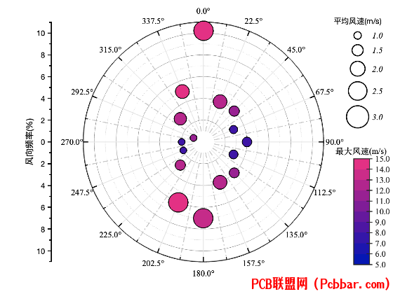

% N' J+ O# X! n( W" {半个月前有粉丝问我怎么画”风玫瑰图“,之前因为时间比较忙所以没有更新,今天有时间抽空介绍一下“风玫瑰图”的画法,喜欢此推文的小伙伴们记得点赞+关注+分享!【尊重作者劳动成果,转载请注明推文链接和公众号名】
4 Q1 h/ Z+ [3 q  t粉丝给的图:! A* W4 ?' ^- A$ o$ ]2 h% _
9 K. p. y# R4 V- x* u( v
复刻的图:
% O4 o8 i- j+ |4 M) M2 A  T" {# D
% Q$ x& L) f4 m4 S' ~( y. G其他样式效果:  c6 y' o& [. W' Y
1 p0 C& A. c4 `# A0 _
( h1 i$ @. b* S5 F# y+ s# l: O  }, _% i' b- H3 s

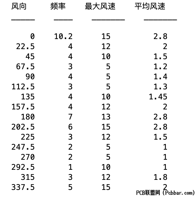

数据数据包含:风向、刮风频率、最大风速、平均风速四个数据。
  • windDirections = [0.0, 22.5, 45.0, 67.5, 90.0, 112.5, 135.0, 157.5, 180.0, 202.5, 225.0, 247.5, 270.0, 292.5, 315.0, 337.5]';windFrequency = [10.2, 4, 4, 3.0, 4.0, 3.0, 4.0, 4.0, 7.0, 6.0, 3, 2, 2, 1.0, 3, 5]';maxWindSpeed = [15, 12, 10, 5, 5, 5,10, 12, 13, 15, 12,5, 5, 10, 12,  15]';avgWindSpeed = [2.8, 2.0, 1.5, 1.2, 1.4, 1.3, 1.45, 2.00, 2.80, 2.80, 1.50, 1.00, 1.0, 1.0, 1.8, 2.0]';data=[windDirections,windFrequency,maxWindSpeed,avgWindSpeed];数据长成这样的
    # I  S0 {9 ]4 H  s% g' |% u- t
    ; Q$ u) _; Y8 i" ]3 U  x: B& f1 k* F8 u8 k

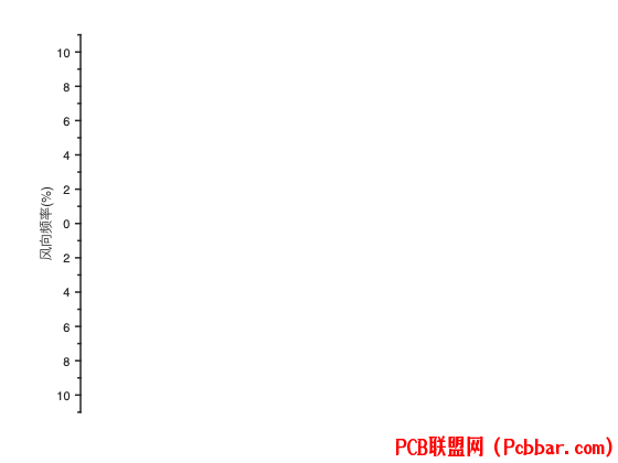

    绘图教程绘制左边Y轴
    $ G4 \! b0 r+ F/ H: i  P
  • % 设置基础参数maxRadius = ceil(max(windFrequency));minRadius = round(maxRadius / 10);dfT=unique(diff(windDirections));allTheta = 0:0.01:360;% 创建并配置坐标轴fig=figure('Color',[1,1,1]);ax = gca;hold on; box off; grid off; axis equal;ax.YLim = [-maxRadius, maxRadius];ax.YMinorTick = 'on';ax.XColor = 'none';ax.XDir = 'normal';ax.TickDir = 'out';ax.LineWidth = 1.5;majorTicksY = ax.YTick;minorTicksY = (majorTicksY(1:end-1) + majorTicksY(2:end)) / 2;diffTicks = unique(diff(majorTicksY));maxRadius=max(ax.YTick)+diffTicks/2;ax.YLim = [-maxRadius, maxRadius];%重新设定ax.YAxis.MinorTickValues = [minorTicksY(1)-diffTicks, minorTicksY, minorTicksY(end)+diffTicks];ax.YTickLabel = arrayfun(@(y) sprintf('%d', abs(y)), majorTicksY, 'UniformOutput', false);ax.YLabel.String='风向频率(%)';& |+ n& |8 K; t1 i! ~
    2 N) H# B& c( R. p' q) S绘制主、次网格和主、次刻度的极坐标区域。
      C  Y% P: O# U( T3 K- K. r7 [" ~
  • % 绘制主要的极坐标网格线majorRadius = majorTicksY(majorTicksY > minRadius);for i = 1:length(majorRadius)    [xMajor, yMajor] = pol2cart(deg2rad(allTheta), majorRadius(i));    plot(xMajor, yMajor, '-', 'Color', [0 0 0], 'LineWidth', 0.5);endmajorTheta = windDirections;fullRadius = linspace(minRadius, maxRadius, 1000);for i = 1:length(majorTheta)    [xMajorT, yMajorT] = pol2cart(deg2rad(majorTheta(i)), fullRadius);    plot(xMajorT, yMajorT, '-', 'Color', [0.8 0.8 0.8], 'LineWidth', 1.2);end% 绘制次要的极坐标网格线minorRadius = minorTicksY(minorTicksY > minRadius);for i = 1:length(minorRadius)    [xMinor, yMinor] = pol2cart(deg2rad(allTheta), minorRadius(i));    plot(xMinor, yMinor, ':', 'Color', [0.55 0.55 0.55], 'LineWidth', 0.8);endminorTheta=windDirections+dfT/2;% minorTheta = 11.25:22.5:360;for i = 1:length(minorTheta)    [xMinorT, yMinorT] = pol2cart(deg2rad(minorTheta(i)), fullRadius);    plot(xMinorT, yMinorT, '-.', 'Color', [0.55 0.55 0.55]);end% 绘制最外层的极坐标线[xOuter, yOuter] = pol2cart(deg2rad(allTheta), maxRadius);plot(xOuter, yOuter, '-', 'Color', 'k', 'LineWidth', 2);% 主刻度线mainTickTheta= windDirections+dfT;% mainTickTheta = 0:22.5:360;tickRadius = [maxRadius*0.96, maxRadius];for i = 1:length(mainTickTheta)    [xMainTick, yMainTick] = pol2cart(deg2rad(mainTickTheta(i)), tickRadius);    plot(xMainTick, yMainTick, '-', 'Color', [0, 0, 0], 'LineWidth', 1.5);end% 次刻度线minorTickTheta=windDirections+dfT/2;% minorTickTheta = 11.25:22.5:360;tickRadiusMinor = [maxRadius*0.98, maxRadius];for i = 1:length(minorTickTheta)    [xMinorTick, yMinorTick] = pol2cart(deg2rad(minorTickTheta(i)), tickRadiusMinor);    plot(xMinorTick, yMinorTick, '-', 'Color', [0 0 0], 'LineWidth', 1.5);end% 添加主刻度外的标签labelDist = maxRadius *(1+ 0.094); % 设定标签距离为最大半径(1+ 0.094),可以根据需要进行调整for i = 1:length(majorTheta)    adjustedAngle = majorTheta(i); % 从正北方开始,并且顺时针增加 % 从正北方开始,并且顺时针增加    angle = mod(adjustedAngle, 360); % 确保角度在0-360之间    [xLabel, yLabel] = pol2cart(deg2rad(90-adjustedAngle), labelDist);    labelText = sprintf('%.1f°', angle);    text(xLabel, yLabel, labelText, 'HorizontalAlignment', 'center', 'VerticalAlignment', 'middle');end; G! H' y3 i. T" [4 b
    9 s9 L2 Z% g" p5 G

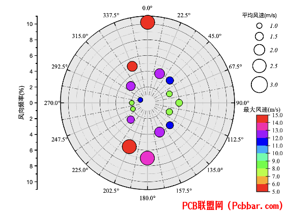

    添加刮风数据,添加数据和颜色、图列大小映射关系。
  • adjustedWindDirections = 360 - windDirections;[xWind, yWind] = pol2cart(deg2rad(adjustedWindDirections + 90), windFrequency);colorGradient = [0.0078, 0.0941, 0.7333; 0.9725, 0.0039, 0.5216];colorMapMajor = makeColorMap(colorGradient, length(windDirections));% 根据风速大小对颜色进行排序[~, idx] = sort(maxWindSpeed, 'Ascend');sortedColorMap = colorMapMajor(idx, :);% 对于相同的风速值,使用第一个出现的颜色值为其赋色uniqueSpeeds = unique(maxWindSpeed, 'stable');for i = 1:length(uniqueSpeeds)    currentSpeed = uniqueSpeeds(i);    indices = find(maxWindSpeed == currentSpeed);    if length(indices) > 1        sortedColorMap(indices, :) = repmat(sortedColorMap(indices(1), :), length(indices), 1);    endendmaxWind = max(maxWindSpeed);desiredMaxSize=max(avgWindSpeed);desiredMinSize=min(avgWindSpeed);for i = 1:length(windDirections)    color = getColorForSpeed(maxWindSpeed(i), maxWind , colorMapMajor);    s = mapToMarkerSize(avgWindSpeed(i), desiredMaxSize, desiredMinSize);    plot(xWind(i), yWind(i), 'o', 'LineWidth', 1.2, 'MarkerSize',s, ...        'MarkerEdgeColor', 'k', 'MarkerFaceColor', color);end# H. A3 o- j$ t/ z( a. A
    7 r& c2 v: y- b# J% @3 n* m颜色条绘制$ r* S: ^( M  i5 G% S$ c: F
  • colorMapMinor = makeColorMap(colorGradient, 10);colormap(colorMapMinor);cBar = colorbar;cBar.Position = [.9 .1 .04 .36];cBar.LineWidth = 1.2;cBar.TickLength = 0.025;cBar.Ticks = linspace(floor(min(maxWindSpeed)),ceil(max(maxWindSpeed)),11);% cBar.Ticks =linspace(minWindSpeed, maxWindSpeed, 11);tickLabels = arrayfun(@(x) sprintf('%.1f', x), cBar.Ticks, 'UniformOutput', false);cBar.TickLabels = tickLabels;cBar.TickDirection = 'both';colorBarTitle = title(cBar, '最大风速(m/s)');caxis([floor(min(maxWindSpeed)),ceil(max(maxWindSpeed))]);AxSize=axes(fig,'Position',[.86 0.55 .1 .36],'Color',[1,1,1]);title(AxSize,'平均风速(m/s)')AxSize.XColor='none';AxSize.YColor='none';meanRLabel=linspace(ceil(0.3),ceil(2.6),5);
    . A# R+ v( e1 C/ E8 e' V- e
    1 G" O+ a8 A& i# A# P5 F添加图列绘制# H  x: ~0 \; {
  • % 定义半径和距离legR=linspace(ceil(min(avgWindSpeed)),ceil(max(avgWindSpeed)),5);d =ceil(ceil(max(avgWindSpeed))/2);% 计算每个圆的中心位置legY = zeros(1, length(legR));totalHeight = sum(2.*legR) + d*(length(legR)-1);legY(1) = totalHeight/2 - legR(1);for i = 2:length(legR)    legY(i) = legY(i-1) - 2*legR(i-1) - d;end% 绘制圆形hold on;for i = 1:length(legR)    rectangle('Position',[-legR(i), legY(i)-legR(i), 2*legR(i), 2*legR(i)], 'Curvature', [1, 1],'LineWidth',1);    text(max(legR) + 0.6, legY(i), sprintf('%.1f', legR(i)));endaxis equal;xlim([-max(legR) max(legR)]);ylim([legY(end)-legR(end) legY(1)+legR(1)]);hold off;  Q5 n, N% `3 D2 a- B

    绘图工具箱介绍默认绘图
    ' }, R$ S3 t# A" o& N3 C; U
  • figure('name','默认绘图')w=WindRosePlot(data);w.plot();

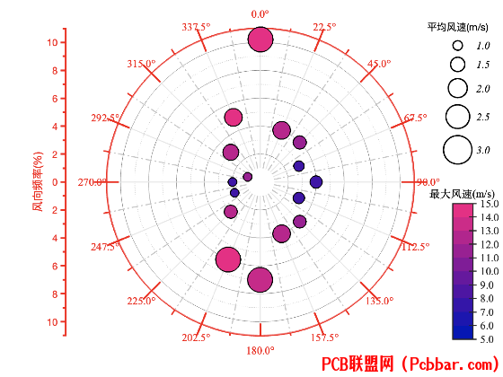

    刻度颜色设置
  • figure('name','设置刻度颜色')w=WindRosePlot(data);w.AxisColor=[0,0,1];w.AxisLineWidth=2;w.plot();
    ) s0 Z( z/ K# {" y: K& x
    6 n% r1 M8 d% z7 K1 M刻度方向和长短设置,其中刻度方向有:'in'|'out'|'both'?。
  • figure('name','设置刻度方向、长短')w=WindRosePlot(data);w.AxisMainTickDir='both';w.AxisMinorTickDir='out';w.AxisColor=[1,0,0];w.AxisLineWidth=2;w.AxisTickLength=0.08;w.plot();8 x' L1 a7 J0 [3 b5 K( E% L

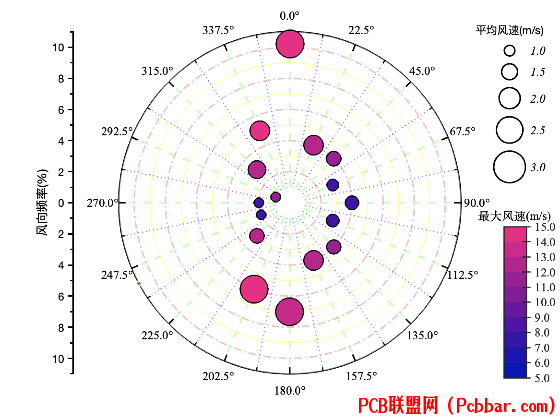

    网格设置:主、次网格的颜色、粗细、透明度设置。
  • figure('name','主、次网格样式、颜色、粗细、透明度')w=WindRosePlot(data);w.RGrid='on';w.RGridLineStyle='-.';w.RGridColor=[1,0,0];w.RGridAlpha=0.5;w.RGridLineWidth=1.5;* z' |, O( @: s! ^  k
    w.ThetaGrid='on';w.ThetaGridLineStyle='--';w.ThetaGridColor=[0,1,0];w.ThetaGridAlpha=0.5;w.ThetaGridLineWidth=2;
    $ I9 B+ F3 m- k  T( m8 p  Yw.MinorRGrid='on';w.MinorRGridLineStyle='-';w.MinorRGridColor=[1,1,0];  C' E1 z, c+ \0 Z+ @" A
    w.MinorThetaGrid='on';w.MinorThetaGridLineStyle=':';w.MinorThetaGridColor=[0,0,1];w.plot();- L6 b6 J# o; W$ }! Y  p- O: L

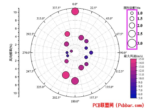

    图列设置
  • figure('name','图列设置:title设置、背景色、边缘色、边缘粗细、字体属性')w=WindRosePlot(data);w.LegendTitle='图列设置Title';w.LegendBackgroundColor=[1,.9,.8]*.98;w.LegendEdgeColor='m';w.LegendLineWidth=4;w.LegendFontName='Times new Roman';w.LegendFontSize=16;w.LegendFontAngle='normal';w.LegendFontWeight='bold';%加粗w.plot();

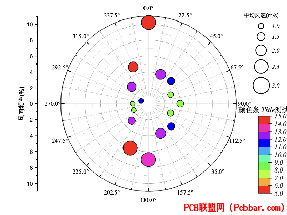

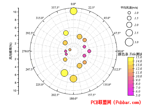

    1 U' _9 f6 F  ^7 l. D
  • figure('name','颜色条设置')w=WindRosePlot(data);% load('colorsData/acton100.mat')% load('colorsData/bwr.mat')% load('colorsData/vikO100.mat')% w.ColorMaps=colorsList;% w.ColorMaps=hsv;% w.ColorMaps=bone;% w.ColorMaps=jet;% w.ColorMaps=winter;w.ColorMaps=spring;w.ColorMapsTitle='颜色条 Title测试';w.ColorMapsFontSize=14;w.ColorMapsFontAngle='italic';w.plot();
