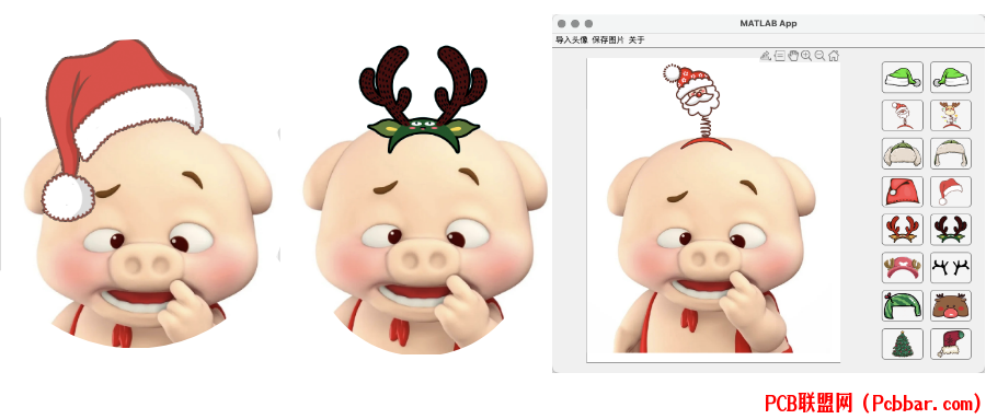

效果图

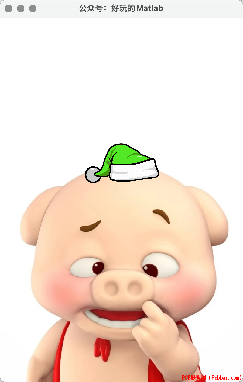

程序介绍
主界面
  • function addHatmFig = figure('units', 'pixels', 'position', [400 300 400 600], ...    'Numbertitle', 'off', 'menubar', 'none', 'resize', 'on', ...    'name', '公众号:好玩的Matlab');axes('parent', mFig, 'position', [0 0 1 1], ...    'XLim', [0 400], ...    'YLim', [-200 400], ...    'NextPlot', 'add', ...    'YDir', 'reverse', ...    'XTick', [], ...    'YTick', [],...    'layer', 'bottom', ...    'Visible', 'on');[avatar, ~, ~] = imread('tx1.jpg');[decorImg, ~, alphaImg] = imread('./img/2.png');ImgResult=image([0 400], [0 400], avatar);添加帽子
  • hatPos = [200, 40];[n, m, ~] = size(decorImg);enlarge=0.08;DrawHatHdl = image([hatPos(1) - m* enlarge hatPos(1) + m* enlarge], ...    [hatPos(2) - n* enlarge hatPos(2) + n* enlarge], decorImg, 'AlphaData', alphaImg);DrawHatHdl.HitTest = 'on';鼠标监听代码
  • set(gcf,'WindowButtonDownFcn', @clickBoat);    function clickBoat(~, ~)        clickType = get(gcf, 'SelectionType');        XY = get(gca, 'CurrentPoint');        if strcmp(clickType, 'normal')            Y = XY(1, 2);            X = XY(1, 1);            set(DrawHatHdl, 'XData', [X - m* enlarge X + m* enlarge], 'YData', [Y - n* enlarge Y + n* enlarge]);        elseif strcmp(clickType, 'alt')            Y = XY(1, 2);            X = XY(1, 1);            enlarge=enlarge*1.1;            set(DrawHatHdl,  'XData', [X - m*enlarge X + m*enlarge], 'YData', [Y - n*enlarge Y + n*enlarge]);        end    endend
    操作方法:
  • 鼠标右击放大帽子
  • 鼠标左击移动帽子位置全部代码
  • function addHatmFig = figure('units', 'pixels', 'position', [400 300 400 600], ...    'Numbertitle', 'off', 'menubar', 'none', 'resize', 'on', ...    'name', '公众号:好玩的Matlab');axes('parent', mFig, 'position', [0 0 1 1], ...    'XLim', [0 400], ...    'YLim', [-200 400], ...    'NextPlot', 'add', ...    'YDir', 'reverse', ...    'XTick', [], ...    'YTick', [],...    'layer', 'bottom', ...    'Visible', 'on');[avatar, ~, ~] = imread('tx1.jpg');[decorImg, ~, alphaImg] = imread('./img/2.png');ImgResult=image([0 400], [0 400], avatar);hatPos = [200, 40];[n, m, ~] = size(decorImg);enlarge=0.08;DrawHatHdl = image([hatPos(1) - m* enlarge hatPos(1) + m* enlarge], ...    [hatPos(2) - n* enlarge hatPos(2) + n* enlarge], decorImg, 'AlphaData', alphaImg);DrawHatHdl.HitTest = 'on';

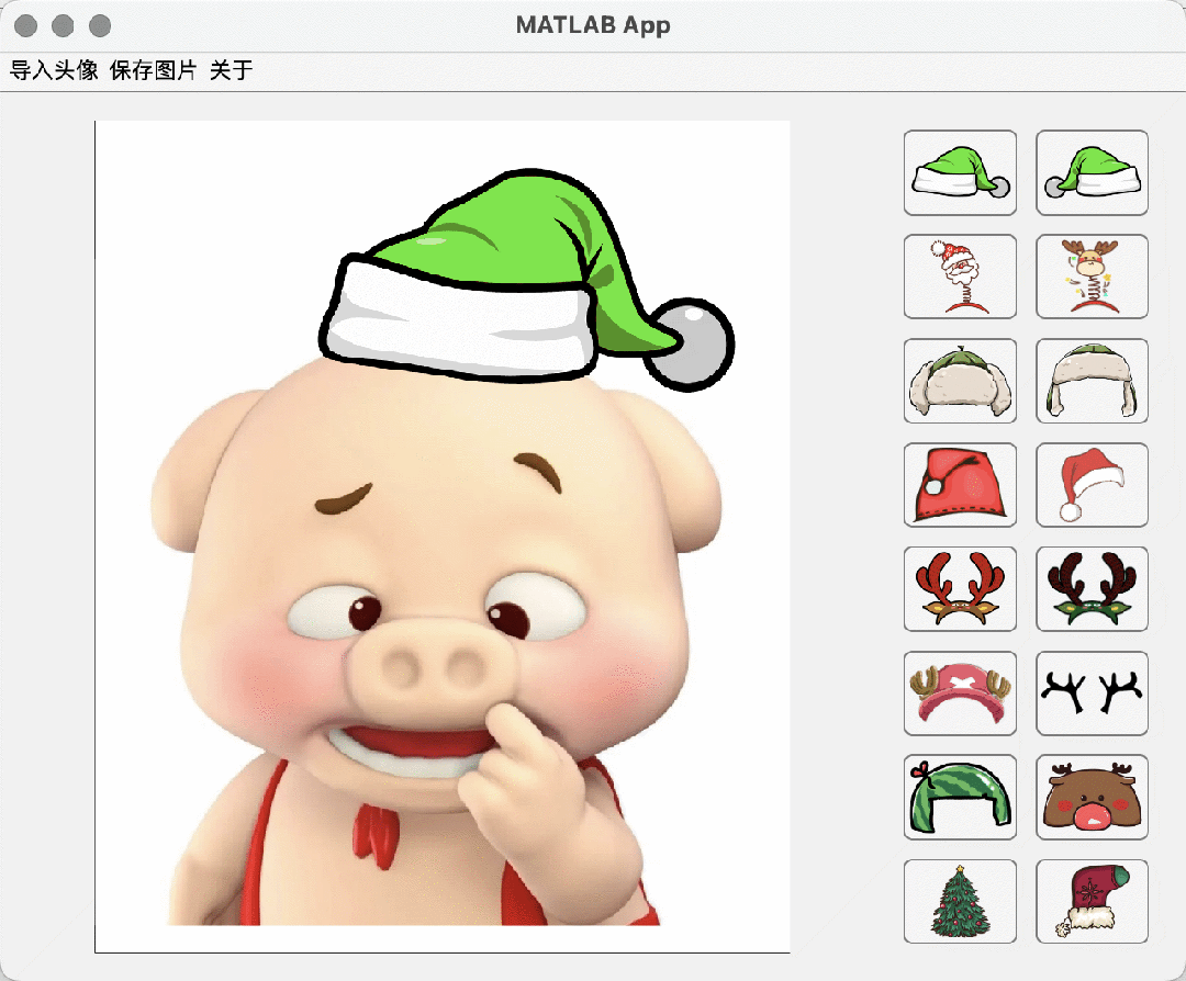

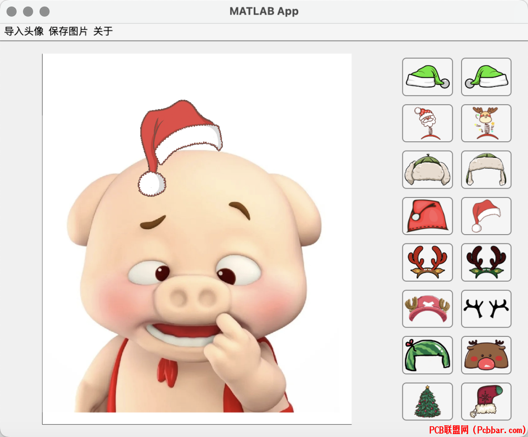

    小编根据原理又做了APP操作界面
