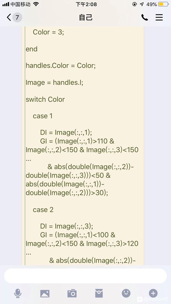

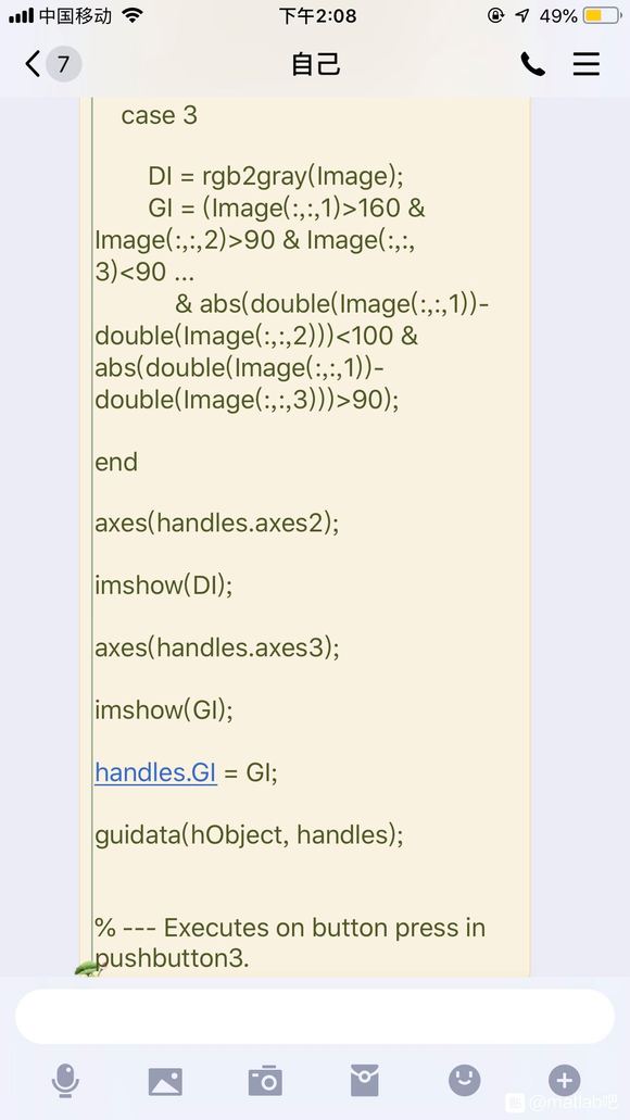

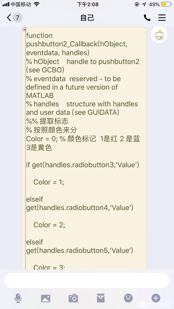

这个怎么理解。是交通标志识别的。求求大佬告诉一下
function pushbutton2_Callback(hObject, eventdata, handles)% hObject    handle to pushbutton2 (see GCBO)% eventdata  reserved - to be defined in a future version of MATLAB% handles    structure with handles and user data (see GUIDATA)%% 提取标志% 按照颜色来分Color = 0; % 颜色标记  1是红 2 是蓝 3是黄色if get(handles.radiobutton3,'Value')        Color = 1;    elseif get(handles.radiobutton4,'Value')        Color = 2;    elseif get(handles.radiobutton5,'Value')        Color = 3;endhandles.Color = Color;Image = handles.I;switch Color        case 1                DI = Image(:,:,1);        GI = (Image(:,:,1)>110 & Image(:,:,2)<150 & Image(:,:,3)<150 ...            & abs(double(Image(:,:,2))-double(Image(:,:,3)))<50 & abs(double(Image(:,:,1))-double(Image(:,:,2)))>30);            case 2                DI = Image(:,:,3);        GI = (Image(:,:,1)<100 & Image(:,:,2)<150 & Image(:,:,3)>120 ...             & abs(double(Image(:,:,2))-double(Image(:,:,3)))>30);            case 3                DI = rgb2gray(Image);        GI = (Image(:,:,1)>160 & Image(:,:,2)>90 & Image(:,:,3)<90 ...            & abs(double(Image(:,:,1))-double(Image(:,:,2)))<100 & abs(double(Image(:,:,1))-double(Image(:,:,3)))>90);        endaxes(handles.axes2);imshow(DI);axes(handles.axes3);imshow(GI);handles.GI = GI;guidata(hObject, handles);        % --- Executes on button press in pushbutton3.

这是app designer里的回调程序吧。。。

表示按下这个按钮就可以实现相应的功能
