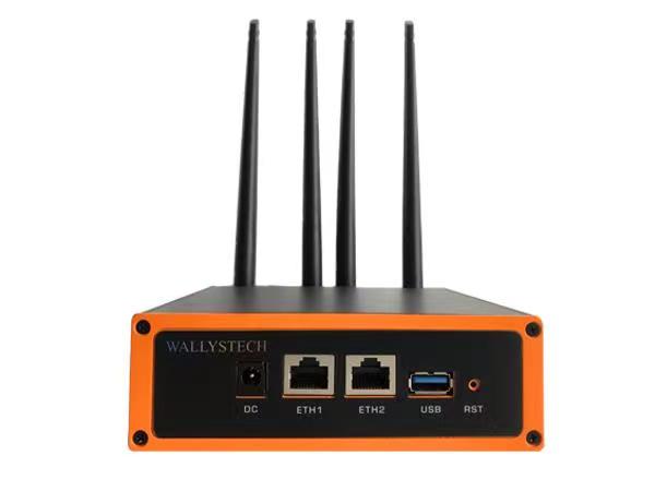

Description
DR-AP6018-S-A is a 2x2 2.4G&5G high power Radio AP Router which including 1x  DR6018-S (IPQ6010) Board;2 x 2.4G&5G dipole Antennas; 1 x PSU(DC power or PoE);
1 x Enclosure.
Dipole antenna
■  2 x 2.4G&5G Antenna
■  5dBi 2.4GHz/5Ghz
■ SMA Plug interface
■ Plastic rod of black
■ RoHS compliance
Enclosure
■  Dimension: 133x 128 x 44 mm
■  Aluminum alloy material
■ Two Version:
DR-AP6018-S-AB (color black)
DR-AP6018-S-AO (color orange)
■  Support Wally DR6018-S
Absolute Maximum Rating
Parameter
Rating
Unit
Supply Voltage
24V~48V(DC Jack)
V
Operating Temperature Range
-40 to +70
oC
Storage Temperature Range
-45 to +105
oC
Operating Humidity Range
5 to +95 (non-condensing)
Hardware Specifications
Symbol
Parameter
CPU
Qualcomm-Atheros IPQ6010
CPU Frequency
Quad-core ARM 64 bit A53 @1.8 GHz processor
System Memory
1GB (2x 512MB) DDR3L 16-bit interface with 32-bit memory bus design
Ethernet Port
1 x 1Gbps Ethernet Ports & POE 1x 1Gbps Ethernet Ports
NGFF Slot
M.2 (NGFF) “E Key” Socket with MiniPCIe 3.0(For WiFi Module)
SD Card Slot
1x SD Card Slot(Option)
USB /header
1x USB 3.0 Port(Option)
POE
24V~48V passive POE/Active POE(Suport 802.3bt)
DC Jack
24V~48V power supply
LED header
2.0 pitch pin header
Serial Port
1x Serial Port 4 Pin Connector
Wireless
On-board 2x2 2.4GHz MU-MIMO OFDMA 802.11b/g/n/ax, max 23dBm per chain
On-board 2x2 5GHz MU-MIMO OFDMA 802.11a/n/ac/ax, max 20dBm per chain
4 x MMCX Connectors
Nor Flash
8MB
Nand Flash
256MB
DDR
256MB~512MB
Dimension
133mm x 128mm x 44mm
