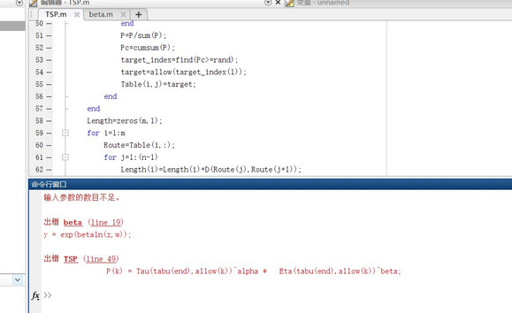

简单的TSP旅行商问题,这个图片的怎么改?感谢各位大佬了

发表于 2022-11-15 13:11:50 | 显示全部楼层
%%清空环境变量
clear all
clc
load citys_data.mat
citys=xlsread('citys31.xlsx','B2:C32');
%%计算城市间相互距离
n=size(citys,1);
D=zeros(n,n);
for i=1:n
    for j=1:n
        if i~=j
            D(i,j)=sqrt(sum(citys(i,:)-citys(j,:)).^2);
        else
            D(i,j)=1e-4;
        end
    end
end
%%初始化参数
m=100;
alpha=1;
bata=5;
rho=0.2;
Q=10;
Eta=1./D;
Tau=ones(n,n);
Table=zeros(m,n);
iter=1;
iter_max=200;
Route_best=zeros(iter_max,n);
Length_best=zeros(iter_max,1);
Length_ave=zeros(iter_max,1);
%%迭代寻找最佳路径
while iter<=iter_max
    %随机产生各个蚂蚁的起点城市
    start=zeros(m,1);
    for i=1:m
        temp=randperm(n);
        start(i)=temp(1);
    end
    Table(:,1)=start;
    citys_index=1:n;
    for i=1:m
        for j=2:n
            tabu=Table(i,1:(j-1));
            allow_index=~ismember(citys_index,tabu);
            allow=citys_index(allow_index);
            P=allow;
            for k=1:length(allow)
               P(k) = Tau(tabu(end),allow(k))^alpha * Eta(tabu(end),allow(k))^beta;
            end
            P=P/sum(P);
            Pc=cumsum(P);
            target_index=find(Pc>=rand);
            target=allow(target_index(1));
            Table(i,j)=target;
        end
    end
    Length=zeros(m,1);
    for i=1:m
        Route=Table(i,:);
        for j=1:(n-1)
            Length(i)=Length(i)+D(Route(j),Route(j+1));
        end
        Length(i)=Length(i)+D(Route(n),Route(1));
    end
    if iter==1
        [min_Length,min_index]=min(Length);
        Length_best(iter)=min_Length;
        Length_ave(iter)=mean(Length);
        Route_best(iter,:)=Table(min_index,:);
    else
        Length_best(iter)=min(Length_best(iter-1),min_Length);
        if Length_best(iter)==min_Length
        else
            Route_best(iter,:)= Route_best((iter-1),:);
        end
    end
    Delta_Tau=zeros(n,n);
    for i =1:m
        for j=1:(n-1)
            Delta_Tau(Table(i,j),Table(i,j+1))=Delta_Tau(Table_(i,j),Table(i,j+1))+Q/Length(i);
        end
            Delta_Tau(Table(i,n),Table(i,1))=Delta_Tau(Table(i,n),Table(i,1))+Q/Length(i);
    end
    Tau=(1-rho)*Tau+Delta_Tau;
    iter=iter+1;
    Table=zeros(m.n);
end
%%结果显示
[Shortest_Length,index]=min(Length_best);
Shortest_Route=Route_best(index,:);
disp(['最短距离:' num2str(Shortest_Length)]);
disp(['最短路径:' num2str( [Shortest_Route Shortest_Route(1)] )]);
disp(['收敛迭代次数:' num2str(Limit_iter)]);
disp(['程序执行时间:' num2str(Time_Cost),'秒']);
以上是代码
