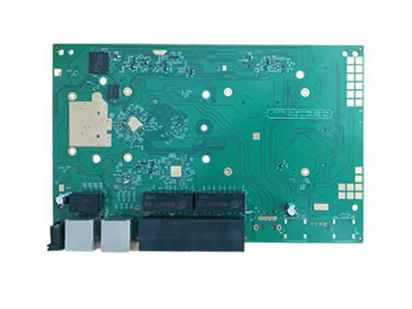

DR5018
IPQ5018, support 2x WiFi 6E Card, support BT5.1
802.11ax IPQ5018 2X2 2.4G
Dual-core ARM 64bit A53@1.0GHz Processor
512MB DDRL3L System Memory
4MB NOR Flash, 128MB NAND Flash
2x2 On-board 2.4GHz radio,up to 573Mbps physical Data Rate
Support BT5.1
Two PCIe2.0 connector can support QCN90xx production
    Absolute Maximum Rating
    Parameter
    Rating
    Unit
    Supply Voltage
    12
    V
    Operating Temperature Range
    -40 to +70
    oC
    Storage Temperature Range
    -45 to +105
    oC
    Operating Humidity Range
    5 to +95 (non-condensing)
    Hardware Specifications
    Symbol
    Parameter
    CPU
    Qualcomm-Atheros IPQ5018
    CPU Frequency
    Dual-core ARM 64 bit A53 @1.0 GHz processor
    System Memory
    512MB DDR3L 16-bit interface with 32-bit memory bus design
    Ethernet Port
    4 x 1Gbps Ethernet Ports  or 1X2.5Gbps Ethernet Port;
    1 x1Gbps Ethernet Port
    NGFF Slot
    2 X M.2 (NGFF) “E Key” Socket with MiniPCIe 2.0(For WiFi Module)
    EMMC
    4G/8G(optional)
    USB /header
    1x USB 3.0 Port
    POE
    NA
    DC Jack
    12V power supply
    LED header
    LED for power ,Wifi strength
    Serial Port
    support
    Wireless
    On-board 2x22.4GHz MU-MIMO OFDMA 802.11b/802.11g/802.11n/802.11ax,max 23dBm per chain
    2x IPEX Connectors
    BluetoothBT5.1
    Nor Flash
    8MB
    Nand Flash
    128 MB
    DDR
    512MB
    Dimension
    185mm x 116mm
      Radio TX Specifications(2412MHz-2482MHz)
      Operating Mode
      Data Rate
      Power
      Tolerance
      1 Chain
      2 Chains
      2.4Ghz 802.11ax HE20
      MCS0
      23dbm
      26dbm
      ±2dB
      MCS1
      23dBm
      26dBm
      ±2dB
      MCS2
      23dBm
      26dBm
      ±2dB
      MCS3
      23dBm
      26dBm
      ±2dB
      MCS4
      23dBm
      26dBm
      ±2dB
      MCS5
      23dBm
      26dBm
      ±2dB
      MCS6
      23dBm
      26dBm
      ±2dB
      MCS7
      22dBm
      25dBm
      ±2dB
      MCS8
      21dBm
      24dBm
      ±2dB
      MCS9
      21dBm
      24dBm
      ±2dB
      MCS10
      18dBm
      21dBm
      ±2dB
      MCS11
      17dbm
      20dbm
      ±2dB
      2.4Ghz 802.11ax HE40
      MCS0
      23dbm
      26dbm
      ±2dB
      MCS1
      23dBm
      26dBm
      ±2dB
      MCS2
      23dBm
      26dBm
      ±2dB
      MCS3
      23dBm
      26dBm
      ±2dB
      MCS4
      23dBm
      26dBm
      ±2dB
      MCS5
      23dBm
      26dBm
      ±2dB
      MCS6
      23dBm
      26dBm
      ±2dB
      MCS7
      22dBm
      25dBm
      ±2dB
      MCS8
      21dBm
      24dBm
      ±2dB
      MCS9
      21dBm
      24dBm
      ±2dB
      MCS10
      21dBm
      24dBm
      ±2dB
      MCS11
      19dbm
      22dbm
      ±2dB
