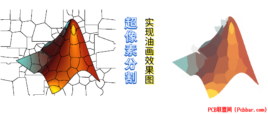

效果图- O  @5 w  p' g- T
; U# V2 A( q$ W% u/ F; v
/ J& U' L, c) p/ N" ^$ Q- x
  Q, D* Z' }4 q/ j- c' ^& }

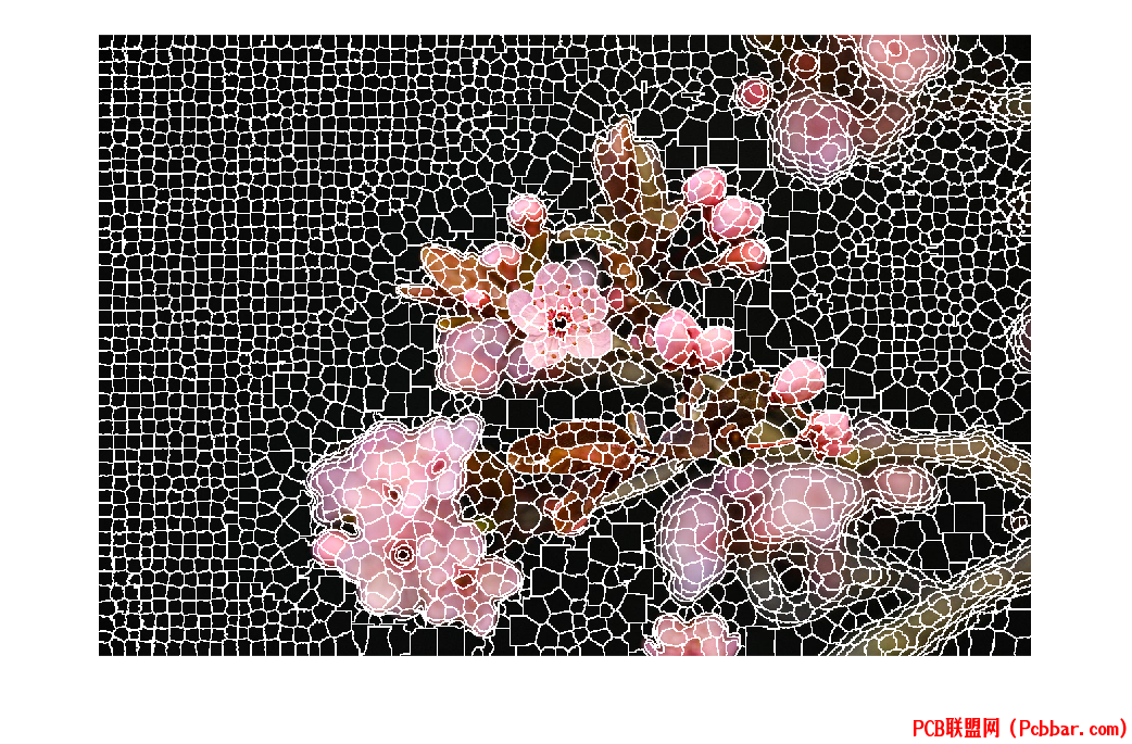

& G- m, d- q# K- d6 [" o/ w绘图代码彩色油画收藏、点赞=学会
  • clc;clear;close all;img = imread('spring-7901015_1280.jpg');[L,N] = superpixels(img,3000);figureimgBW = boundarymask(L);imshow(imoverlay(img,imgBW,'w'),'InitialMagnification',67)opImg = zeros(size(img),'like',img);idx = label2idx(L);numRows = size(img,1);numCols = size(img,2);for labelVal = 1:N    rIdx = idx{labelVal};    gIdx = idx{labelVal}+numRows*numCols;    bIdx = idx{labelVal}+2*numRows*numCols;    opImg(rIdx) = mean(img(rIdx));    opImg(gIdx) = mean(img(gIdx));    opImg(bIdx) = mean(img(bIdx));end    figureimshow(opImg,'InitialMagnification',67)
